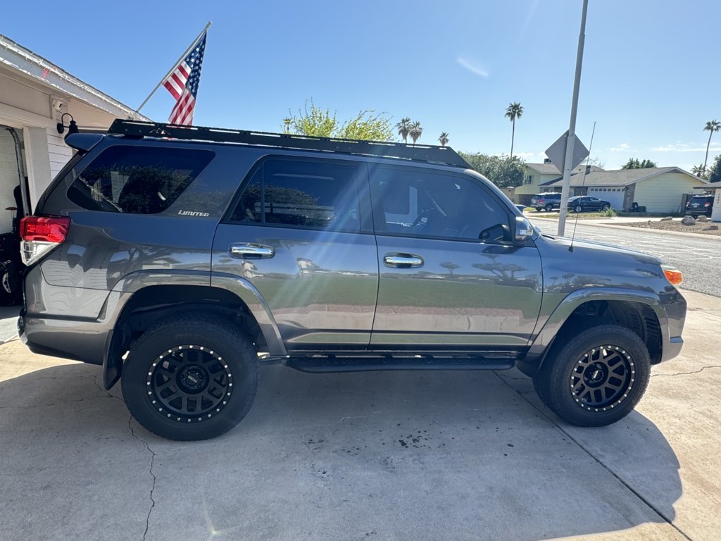

    Understood, the question I would like to know is why not reuse the limited rocker panel molding (plastic) as opposed to buying a brand new rocker panel from another trim level?
  6. May 25, 2025 at 4:17 AM
    catbrown357
    catbrown357 New Member
    Dec 19, 2023
    #37386
    1,113
    Tempe
    2011 Limited 4WD
    Because it requires a lot of time, measuring, custom cutting and patience. I have a combo of customized rockers that were original that I cut, and fender caps and mudflaps from an SR5. The other reason is because the original running boards mount lower on the limited, therefore the rocker panel covers extend lower. In order to fit any aftermarket sliders or steps on the limited, you either have to remove the stock rocker panel covers (which is ugly AF), or modify. Believe me, it takes some balls to start cutting on your paint matched rocker panels. But it works as long as you're careful.IMG_0208.jpg
    glwood54 likes this.
  7. May 25, 2025 at 7:25 AM
    7,257
    ^^^That. You can't remove the Limited rocker panel trim, install sliders or steps meant for the other trims, then just slap the rocker panel trim pieces back on. They either have to be modified, pretty extensively, or replaced with rocker panel trim from the other models.
    There used to be an aftermarket company who offered steel replacement rocker panels, Shrockworks, but they went belly up.
