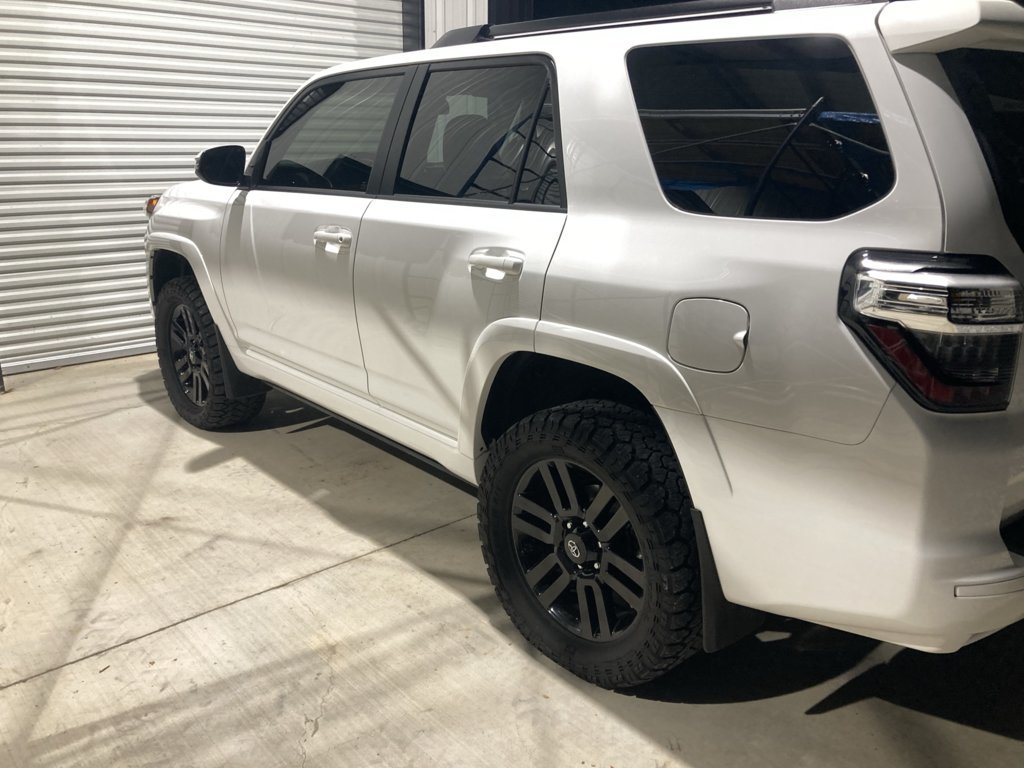

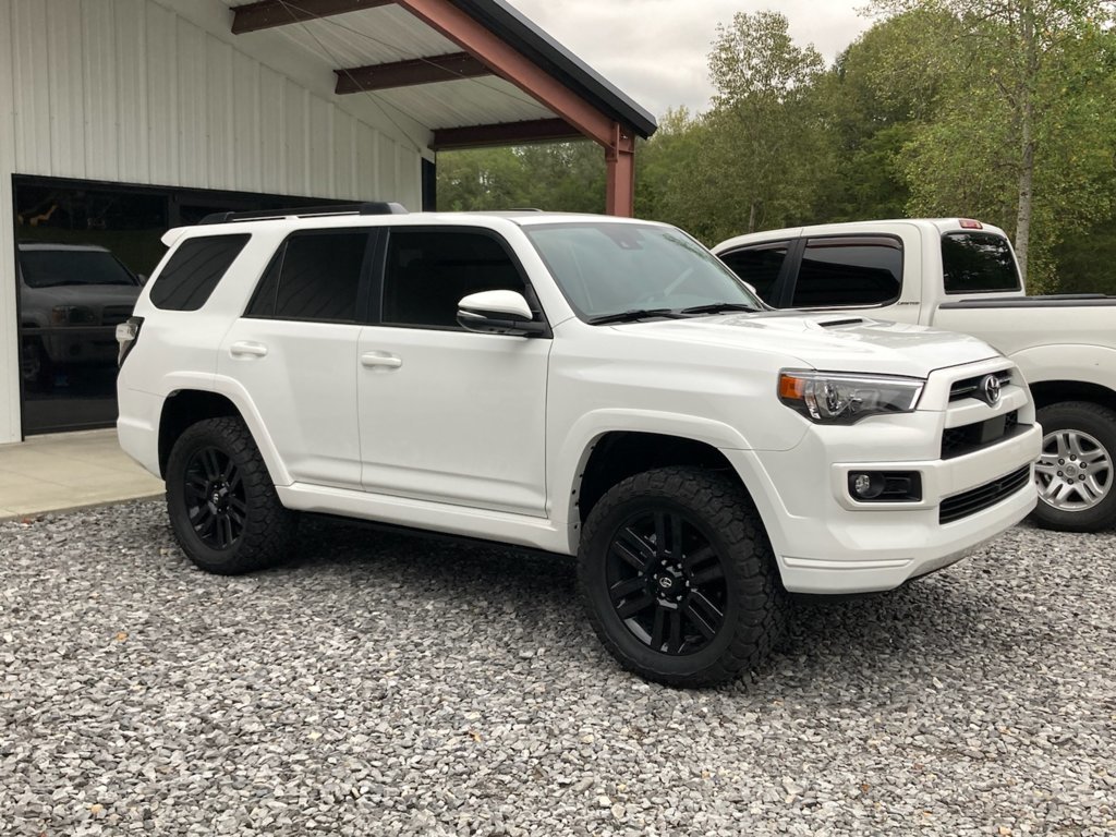

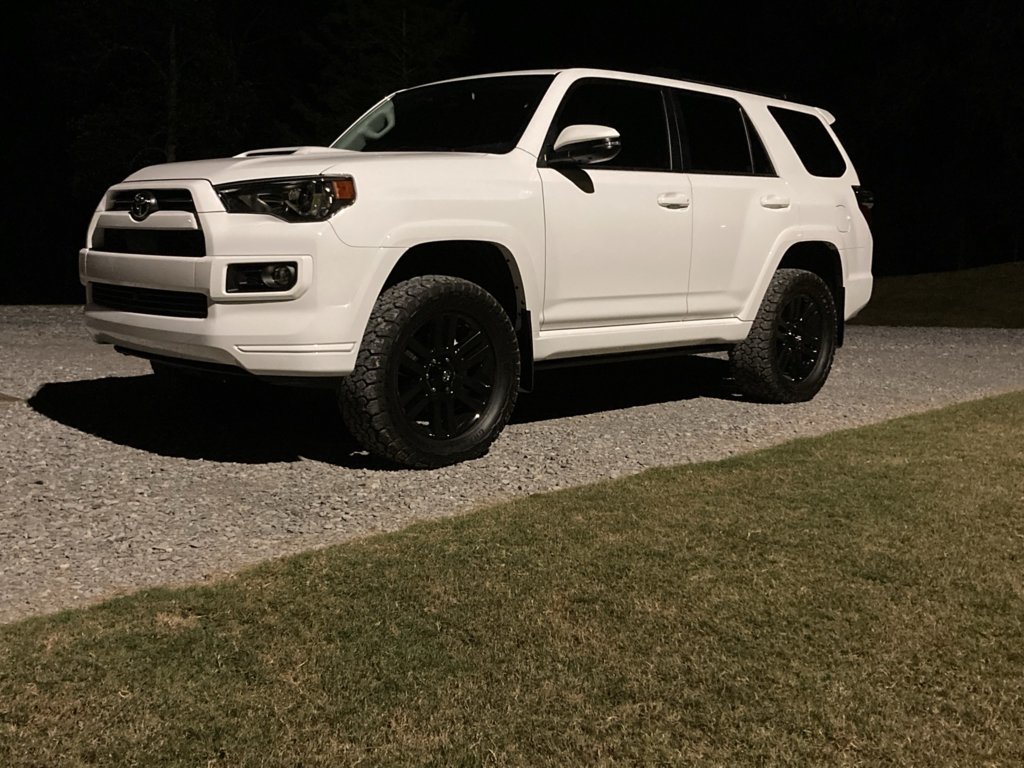

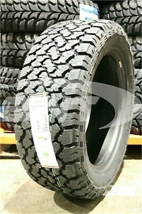

    For the OEM 20" wheels and no lift, you are going to probably want to run a 275/55-20 tire. This is wider, only SLIGHTLY taller like 1/2" or so, but its MUCH beefier on the factory wheels.
    Personally i have the General Grabber ATx tire, this is an all terrain that lasts forever, rides great, looks good with its side biters on the sidewall, does great in the snow, sleet, rain, ice, and heat. I really like the General Grabber AT/x tire and they have them in a few sizes but the 275/55-20 is the best fit for a stock vehicle that you dont plan to lift.
    The 285 will require 2" lift
    The 305 will require 2.5" or more lift
