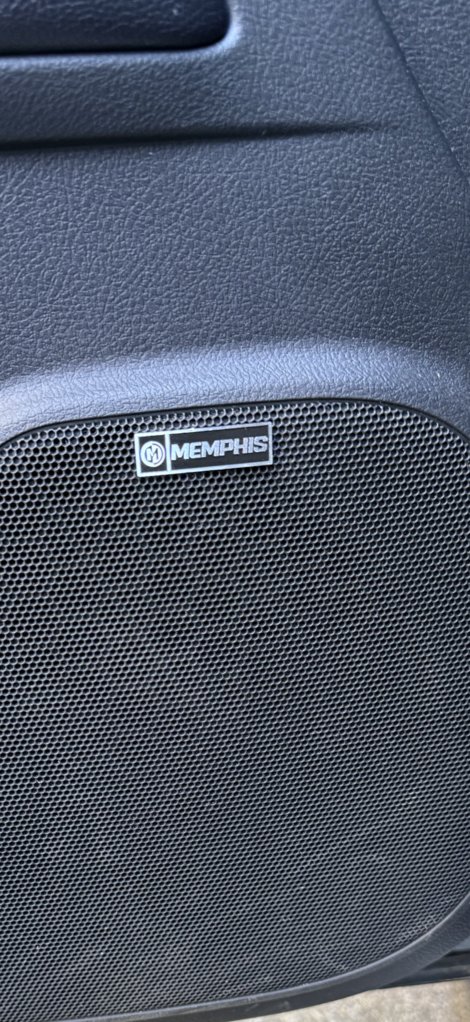

    I finished off my front 6x9 speaker install with this little touch:

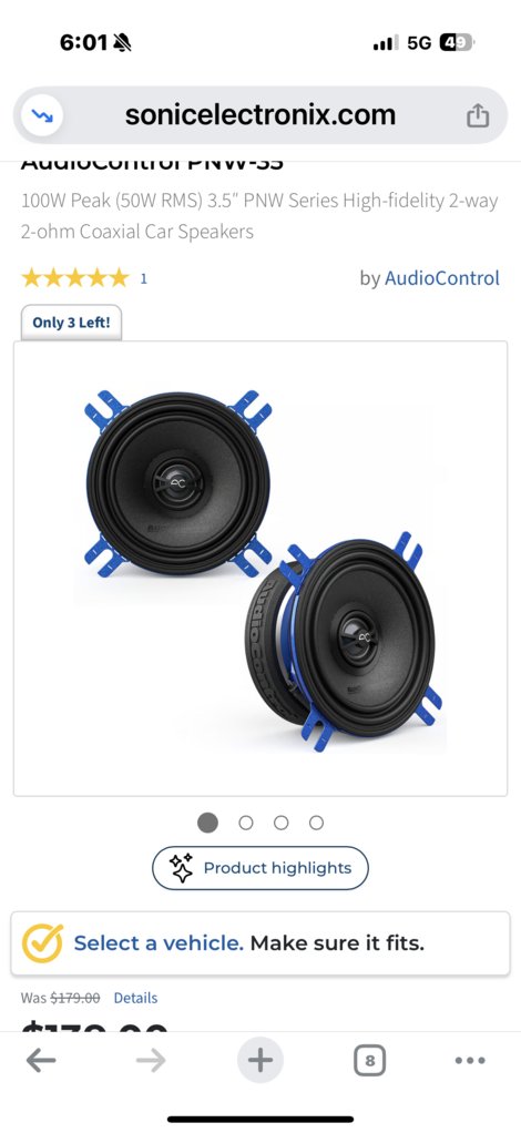

    I’m new to Auto tunes so I made an intial mistake bc Sonic Electronic claimed the little JL Audio 2 1/2” speakers worked. And SO lesson one- when Crutchfield or Sonic say a speaker works in your car they are only referring to if speaker fits the existing factory hole/space. I checked before installation and I realized i needed to know the specs of speakers and the JBL system, esp Impedance- and the JLs were 4 ohms. It took two separate searches and two calls to confirm the JBL system in 4Runner is a 2 ohm system- the JLs are 4ohm.. Loss of volume for a currently medium power system would not work. After a search to find 2ohm dash speakers- which are 2”” ended with 3.5” Audio Connects. Installation was easy but required cutting of existing factory speaker metal harness. Tip 2: Sonic DOES NOT include the correct direct connect wiring harness with their speakers! -I cannibalized old and new too get dash speakers in.. it happened again when I purchased 6.5” speakers a couple weeks later from Sonic. Additionally. If not for Crutchfield tech support I’d have been done.. during cannibalizing I needed to connect Purple green-light blue wires together to black/whites from new and old

    S0 how did new Audio Connect 3 1/2 2ohm dash sound? Awesome.. but when you isolate these speakers you realize how little watts is sent to them- the Audio Connects were over kill- I knew it was just a tweeter I just wish I’d figure out better setup… maybe should have got the 6x9 front 1way with it’s separate tweeter package. I believe that is called component speakers— I just didn’t slow myself to learn about it. Component speaker like ones linked here would have been cheaper better option for front door- dash tweeter- HOWEVER the linked Memphis speakers are 4ohm- it was hard finding 2ohms.. just to clarify for those new to auto tunes the front JBL system speakers of front door and dash is ONE speaker in conventional sense. The f door is the bass/woof and the dash is the tweeter.. I’m dont protest to be expert just dangerous enough to try to do myself SO don’t ask where the MID is generated from.. I’m use to 3 way co axial speakers with a sub connect off amp to ADD more base… PLEASE double check everything I say..

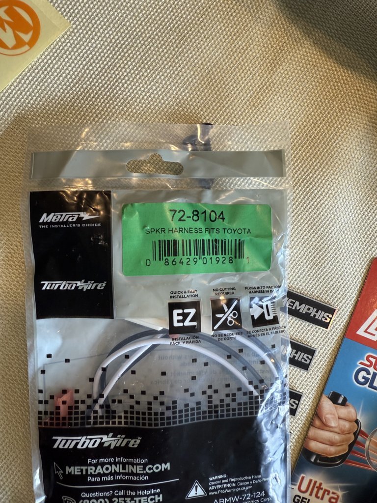

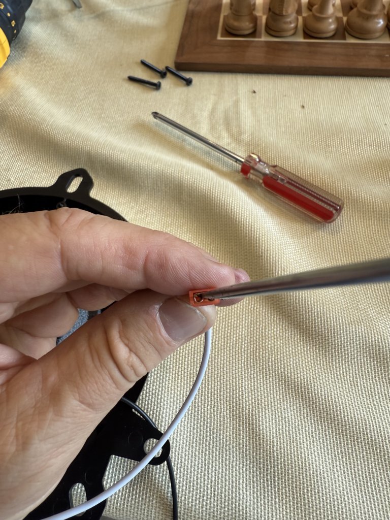

    To finish up front speakers: For front door I used Memphis Audio PRX 6x9s from Crutch. There are not many 2ohm choices so this seemed to be not too cheap not too expensive option. they Fit perfectly AND Crutch provided the Correct Direct connect Metra harness.. 8104s. But be warned- these harnesses are sometimes a bitch and need to be opened up (pic). Bc they were a bitch by the last speaker set I did- rear door- I completely assembled speaker harness and included brackets ( needed for hatch and rear door) before I installed into doors. The Memphis 6x9 sounded much better- controlled and sweet. I’m going to next post how I did my very last door speaker- I always ask myself how can I make this easier and quicker- well by the last door I discovered a HUGE tip you will def want to use- professional or amateur.. I may patent it-lol
