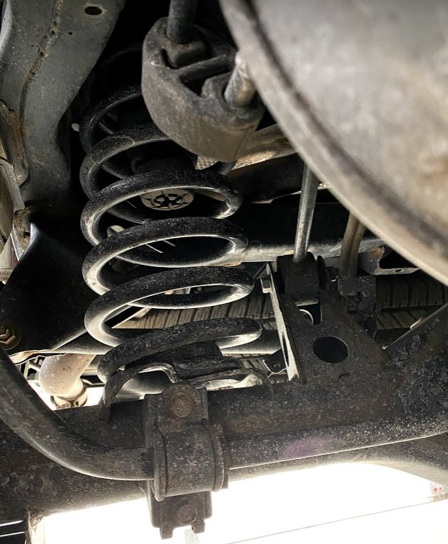

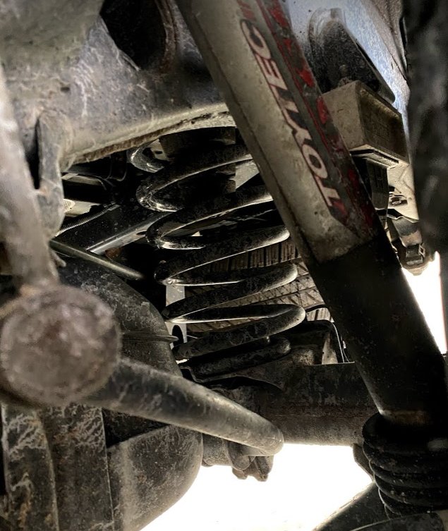

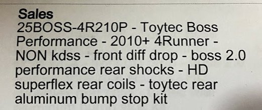

    Jake - many thanks, and my apologies for my incomplete information. Here are some details:
    1. No KDSS
    2. I am unsure of the spacer setup, but I do know that he installed a 25BOSS-4R210P kit, with Boss 2.0 performance rear shocks, HD superflex rear coils, and a Toytech rear aluminum bump stop kit.
    3. Here are some pics of the rear springs:
    Left Rear:
    Right Rear:

    I don’t see any spacers there, so my guess is either it was installed incorrectly, or one of the springs is sagging, badly.
