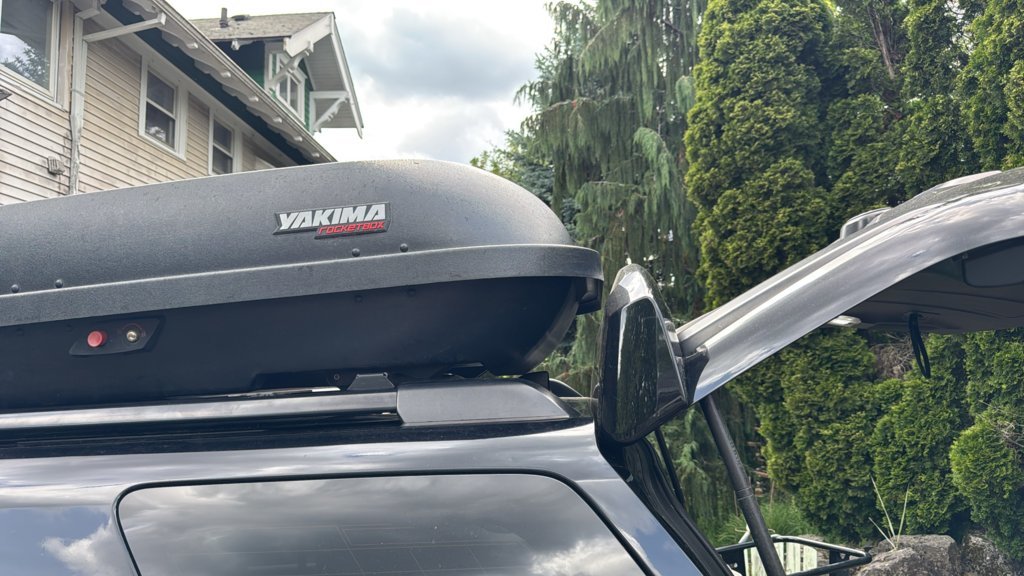

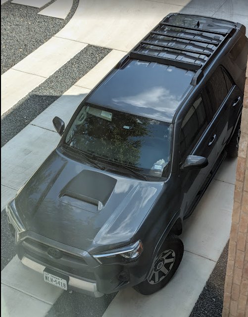

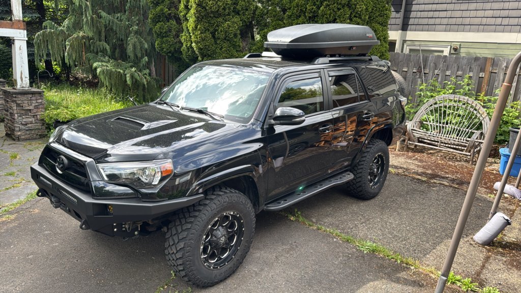

    377657FB-2E6E-4CE0-8D50-47CFCE144157.jpg 9E02871B-E163-40EB-A6E2-BD3EE492F284.jpg F5F3A1AF-A64B-4537-902D-34653B5A3F7C.jpg I have them on my ‘19 and like them generally. 4 bars and the first is the wind stop. Shark fin is lower and not an issue for anything I have carried.
    3 weeks ago, I borrowed a Yakima box and found I had to remove one bar and move one far forward to get the clamps to fit. All was well, however with the box favoring driver or passenger, the front clamp nearest the center of the truck had about a millimeter of space between the roof and the clamp. If I centered the box, it was more like a 1/2 inch.
    also, when on a rugged road, the box would shift sideways by at least an inch over large bumps. (I should drive slower)
    since it was a temporary borrow for a trip to Yellowstone, I was ok with it. If I owned it, I would have to hard mount.

    This seems to be the issue with many of the crossbars. @OP: The Yakima and Thule style crossbars that sit on top or above the roof rails aren’t an issue, but the crossbars that mount between the rails are another story and many folks report problems with the roof box claws scratching the paint.

    yes and most of my use case does not encounter this issue, only the claw of the box I borrowed.
    I carry a shovel, kayaks, Lumber, etc. without issue.
