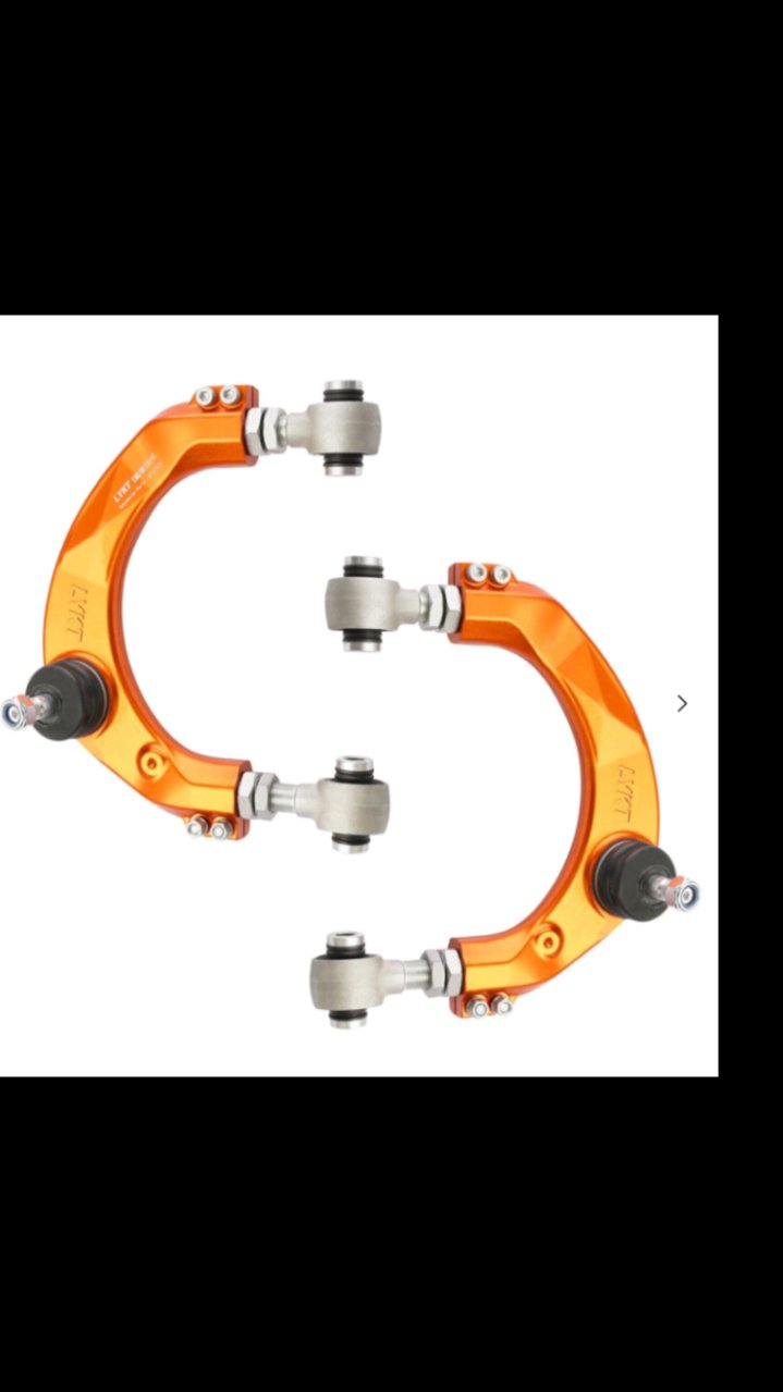

  14. Jan 15, 2023 at 3:59 AM
    6,728
    20201222_095107[702]JBA UCA.jpg Our choice. They provide excellent caster adjustment, are greaseable, designed well, and affordable.
