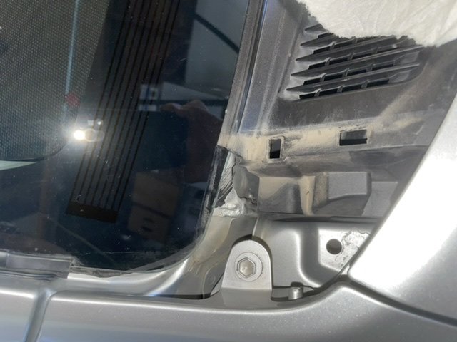

    When I had my windshield replaced this year I saw how the technician had to remove the wipers and plastic cowling to accomplish the job. This exposed the large oval cutout which is the air intake port of the HVAC. Underneath it is the cabin filter and no wonder mice are attracted to it, it’s a nice little comfy nesting area for them.
    So I decided to cover it with some screen to exclude them, or at least make it more difficult for them. And to keep out the leaves and pine needles that sometimes get sucked in.
    First, you have to remove the windshield wiper arms. Start with the driver side. Pop off the plastic caps with a good grip of your fingers. Straight out. No need for any tool. Remove the 14mm nut with a socket wrench.
    Then work the wiper arm off the toothed shaft. It’s kind of a pain but you have to wiggle and lift for a while to work it off. Repeat on the passenger side.
    Lift the hood and remove the two push-pins, one on each side of the plastic cowl under the windshield. Like the ones one radiator cover. Push down the center with your finger and gently pull the whole thing out of the hole. Pop the center pin up to prepare it to re-install later.
    Remove the small plastic end pieces at each lower end of the windshield. There are some clips on the lower edge and a pressure fit wedge at the top. Gently use a plastic trim tool to pry it up and out. Take your time.
    The plastic cowling is held down with plastic clips. Push them toward the rear of the vehicle to release them. Pull the cowling toward you, away from the windshield, and set aside.
    Now you can see the air intake opening in the passenger side. Clean it up as needed with a vacuum and isopropyl alcohol.
    I took a piece of cardboard, about 10 x 4 inches, repeatedly trimmed it so it would fit snuggly over that hole, to make a template. When satisfied with the fit I used the template to cut a piece of enameled gutter screen to match it.
    Laying it on top of the hole I temporarily taped it down snug in a few places and spot tacked it down around the perimeter with my favorite E6000 clear adhesive. After it cured I removed the tape and tacked those edges with more adhesive.
    Let it dry, test your HVAC, reassemble, raise your favorite beverage, and toast to the resistance!
