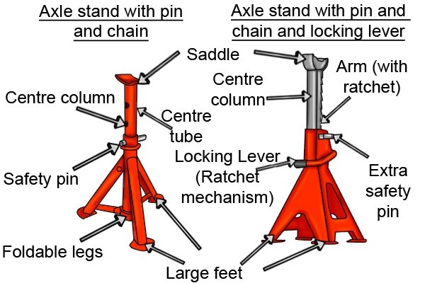

    I just researched this. The jack stands to get are made by pro-lift, they have the best quality welds for the price and have a safety pin. This video shows what I mean by this. I went with AC delco 3 ton stands and they work and I cant drop the ratchet mechanism without raising the saddle a tiny amount so its still safe. This next part wont make sense without understanding some terminology so I'll include a photo depicting the parts of a jack stand.
    The only thing I don't like about the AC delco stands is that they lack a safety pin and I don't have to lift the locking lever that much before it drops the center column. But with the weight of a vehicle lifting the locking lever just a little bit is close to impossible.
    The pro-lift jack stands have a locking pin which is good, and they have the best quality welds so I would choose the 3 ton stands from them.
