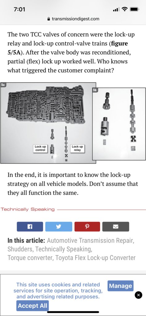

    This is my story with the Shudder/Chatter.
    Long story but cause is in the tranny valve body of my A750 tranny-the FlexLock valve & solenoid system that controls the locking and unlocking of the torque converter friction plates.
    My dealer replaced my tranny at 48,000 miles.
    Toyota has long history of failures and technical bulletins for its unique FlexLock system.The problem is in the tranny valve body not the TC which is the symptom. Hopefully your issue is something else. If you have an A750 tranny try driving in S4 and see if it does not happen.
