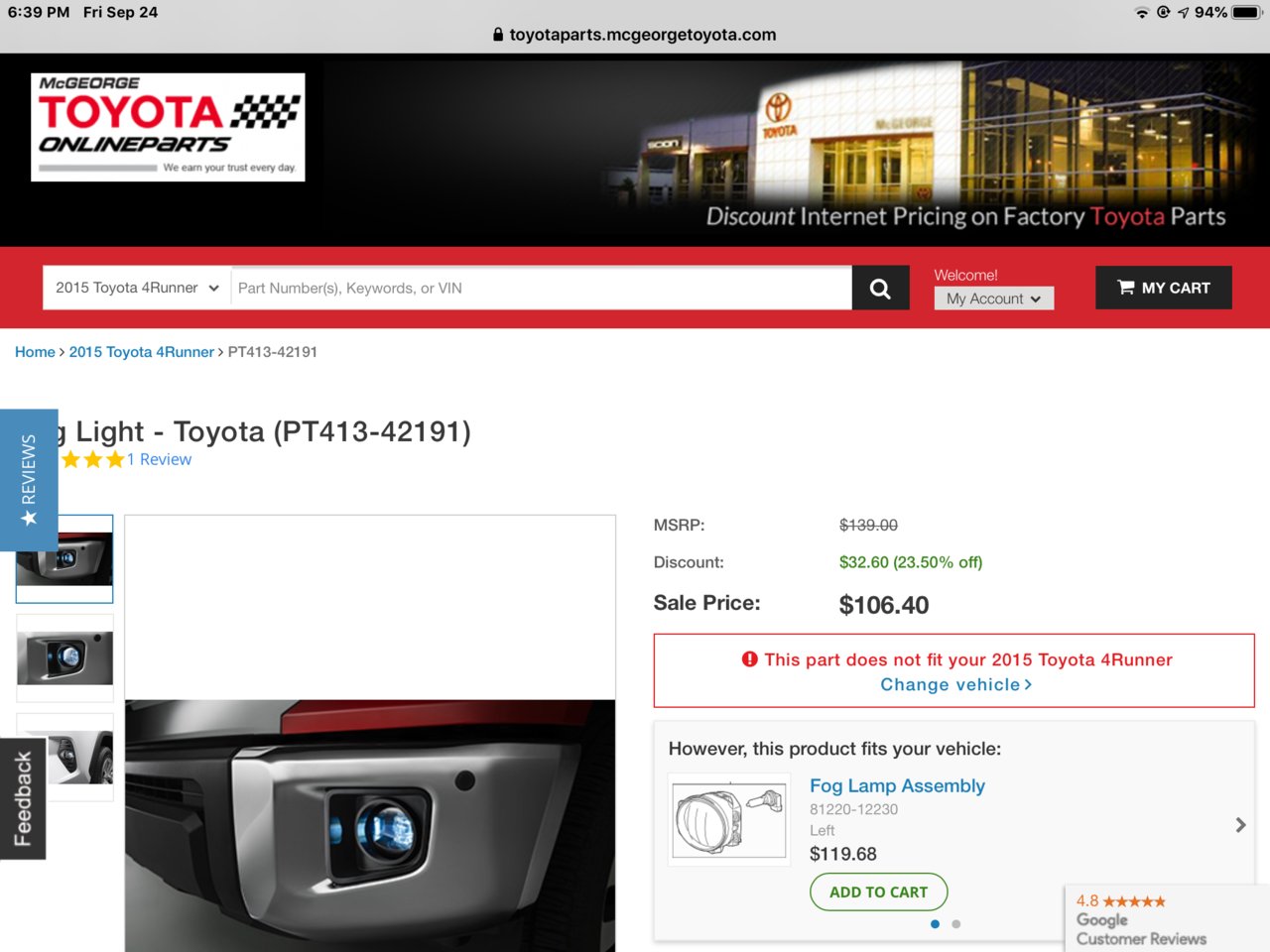

    I replaced halogen fogs on my 2015 sr5 with Toyota led fogs.direct fit plug and play! Huge improvement for a small price... I have both original halogens if you want them.. Toyota may say they don’t fit, but they do

    Thanks how much was the new led fog lights OEM

    The Toyota led’s are $106.00 new...
