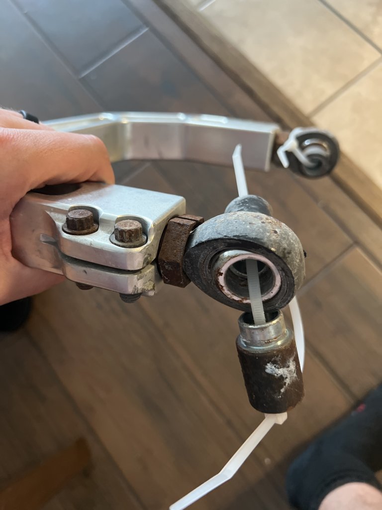

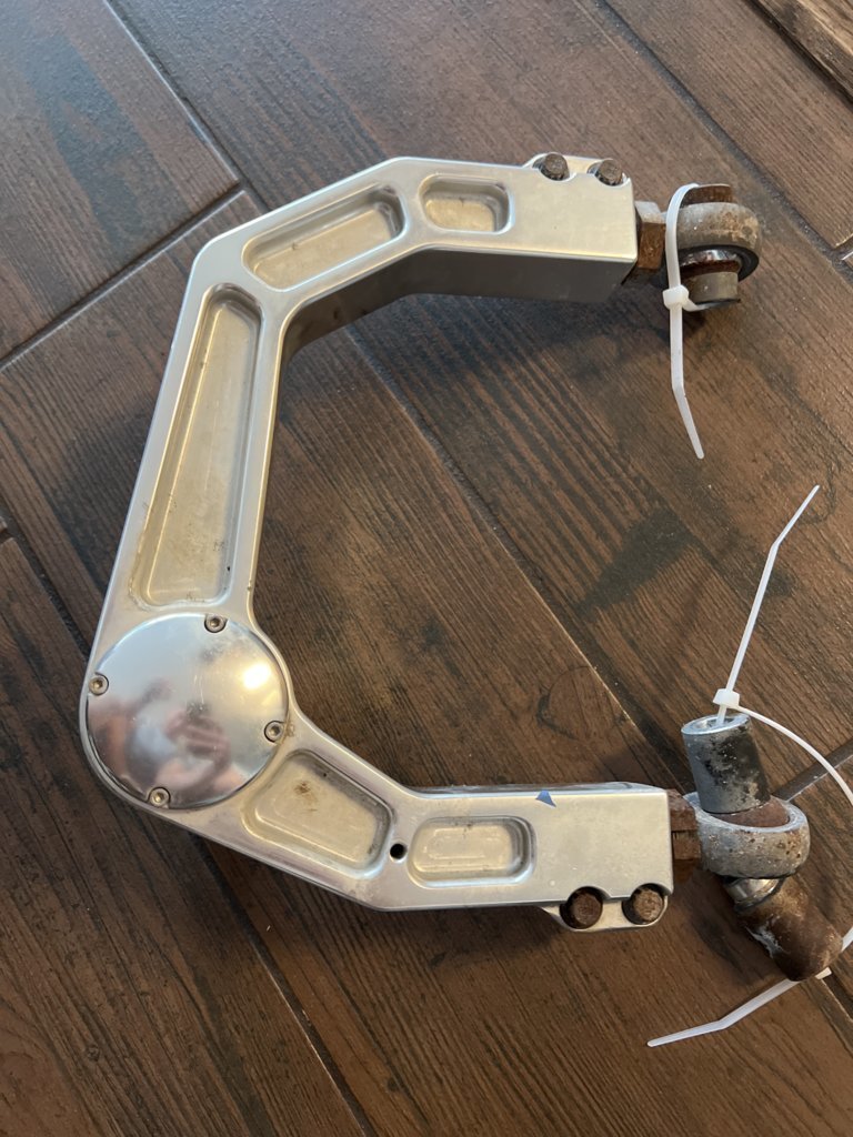

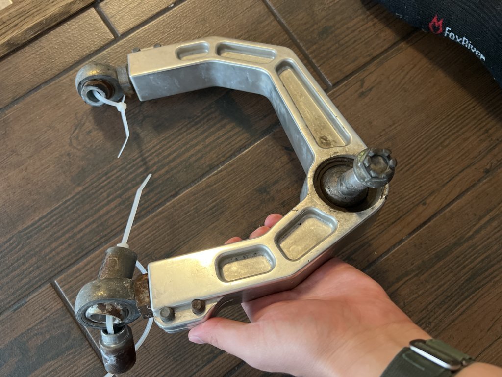

    Today I secured a hell of a deal. $75 for a set of the ICON Billet UCAs with the full front and rear sets from Donahoe Racing. (Pics attached later in post) A fella nearby ditched them from his FJ and wanted them gone rather than wanting a profit. I know the UCAs are certainly salvageable and I know it will all take some effort and additional cash to capitalize on this bargain. I just have a few questions.
    1. The UCAs definitely need new bushings and a new ball joint. No doubt in my mind. What else are some concerns I need to look out for with these cool-cats? image.jpg image.jpg image.jpg

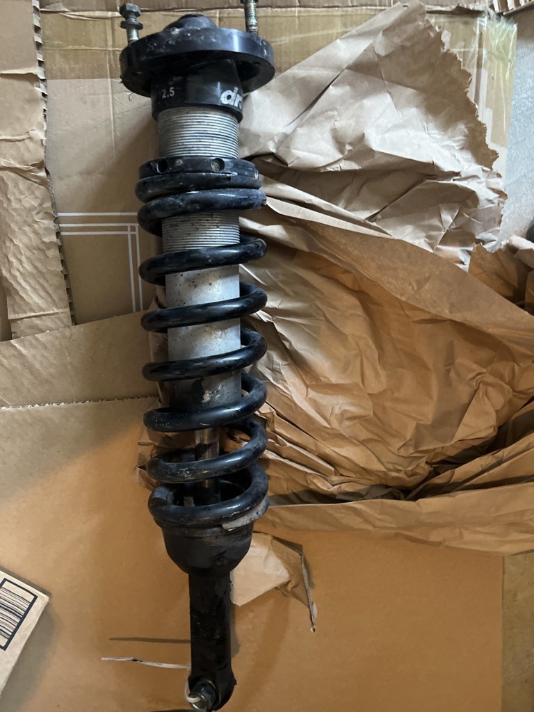

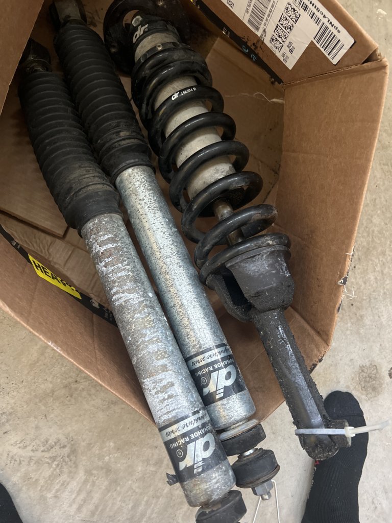

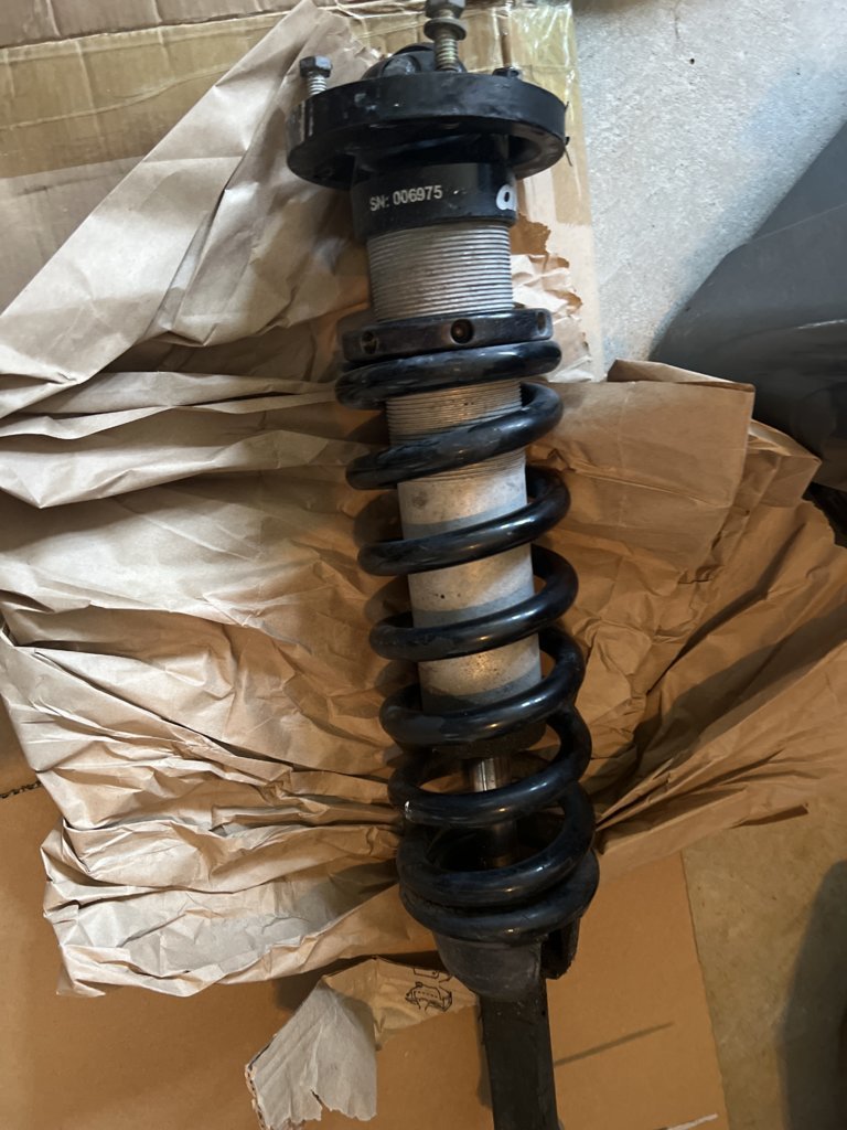

    2. This Donahoe Racing set. I understand that they were purchased out by ICON. That’s pretty cool and all but is it still possible for me to get these serviced appropriately? If so, who’s a reputable source? I’m kind of lost thus far looking into it. I would love to capitalize on this opportunity to give my vehicle a decent lift. God only knows how many miles are on this set. More pics below.image.jpgimage.jpg image.jpg
    3. Final questions in this post. As you might have seen from these pics immediately above, there’s a leak. Still salvageable for this defunct brand? I know there is a hell of a lot more that some experts (possibly some of you) would like to see before they make final verdict. But let’s say… If salvageable, what financial damages am I about to expect?

    1. The exposed heim joints will require spraying with teflon lube after every month and after every wheeling trip or they will squeak like crazy. Even with intensive upkeep they will probably wear out in a year or so and require replacement again. Race truck parts, race truck maintenance. Ironically these chineseium copies will last longer, with sealed flex joint inner pivots and off-the-shelf replaceable ball joints: https://www.amazon.com/dp/B0CGLZLHJZ/
    2. The shocks might be rebuildable with current Icon parts. Better to email Icon and ask directly. They may have had design changes that render their current rebuild kits incompatible, in which case you're SOL.
    3. Rebuild costs can be as much as half the cost of new shocks depending on what the shop finds. The rear shocks look like 2.0" dia. IFP? They won't be economical to rebuild, because new ones are under $200 apiece: https://www.amazon.com/dp/B00F6E7WNI They're pretty nice in my experience:

    Reach out to John Arriola at Keen Shockworks about those shocks. He can tell you if they’re salvageable/rebuildable at the this point in time. He does great work at an affordable price and you can send them in for a quick turnaround if parts are available.
    UCAs should be rebuildable with an Icon parts kit. I’d call Icon and check to see if any of the size/specs have changed since they’re older UCAs. FK probably has heims that will fit if Icon doesn’t.

    2. They unfortunately seem to match up one to one with ICONs 2.5 coilovers that are interchangeable for only 07-10 FJs, and 4th Gen 4Runners. Why that is, I’m not too sure yet b/c I would have thought that the front ends for 4th and 5th gens were fairly similar and close in geometry? I’m not calling quits on that just yet though.

    The lower shock bolt clevis spacing is wider on 5th gen, that's it. For coilovers it just means either longer reducer bushings or an added washer is used on the lower bearing. The lower bearing and reducer bushings are wear parts and typically replaced during a rebuild, so that's no loss.
    I was more referring to internal design changes e.g. hypothetically new seals don't fit old design piston and now you need new piston and new shaft, etc. If 50% of the parts in the shock need to be replaced, then the rebuild may become uneconomical.
