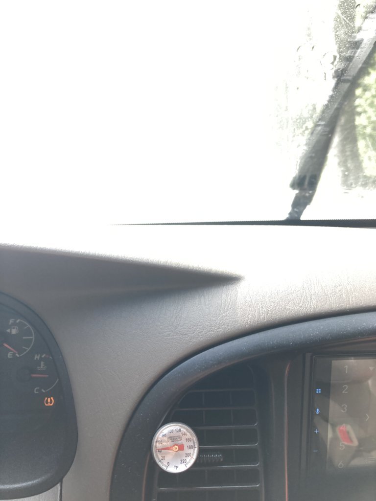

    It started raining here a bit ago, raining hard, i guess the cold water thru the condensor really helps. My old Tundra got down to about 45ish degrees
