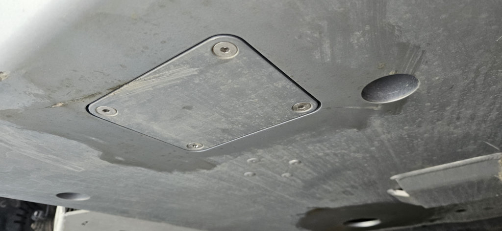

    This is my 12th oil change (oil change interval thread!), 1st with an aftermarket skid plate with the stupid hole and door through the skid.
    I can unequivocally say I hate it, and I will just drop the skid each time. Ive never spilled so much oil all over my garage, myself, the top of the skid, my tools, and my ego.
    Heck to these access ports

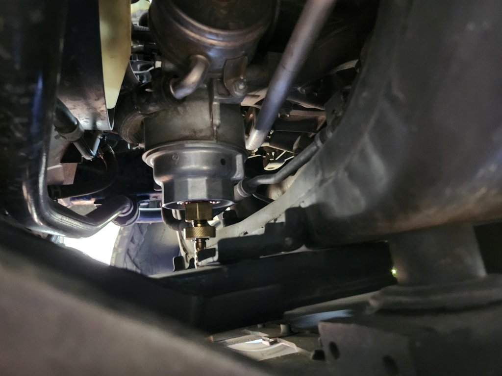

    Get this drain tool/hose so that you can drain as much as you can the filter housing before you take it down. That is the only way IMO to try and keep everything spill-free.
    My goal everytime is zero harm, zero spills.

    Have you considered one of the oil change gadgets to help with draining? e.g. Fumoto or Valvomax?
    Really made a difference in reducing the mess with my oil changes.

    What brand of skid is that ? Are you saying there’s not enough access through those openings ?

    Its the Greenlane Offroad skid, which I have nothing but praises as far as protection goes. I had the both front tires off the ground and the skid on a boulder and all that was on it was a scratch.
    There is certainly enough room to get tools/hands in and out, but its not fun. Given that there are just as many bolts to drop the entire skid as there is to access the door, I'll just drop the skid next time.

    Greenlane Offroad. Read above, but again nothing but praises as far as their skid quality/protection goes.
    I'm beginning to realize maybe its not the skid's fault, and more of Toyota's design. The skid manufacturers are just trying to compensate for the silliness from Toyota.

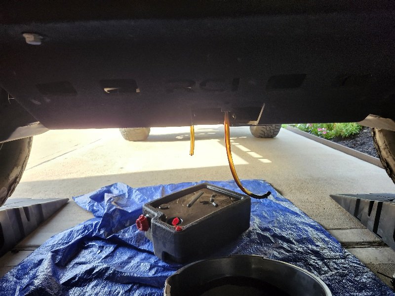

  20. Jul 5, 2025 at 8:15 PM
    HuskyMike
    HuskyMike New Member
    Jan 23, 2023
    #30835
    681
    I have the Valvomax to replace the oil drain plug and the Powerworks filter drain tool from Amazon. Both work great.
    My only minor gripe with both of them is that I'd like a little more flexible tubing (easy enough to replace). They both have that hard(er) plastic tubing that can kink when you are twisting, bending it etc.
    The beauty of both of them is that I can route the hoses directly into the small hole in my Flotool drain container. I barely get any oil on the canister at all. e.g. no draining the oil into the catch area, waiting for it to drain into the container and then have to wipe off the catch area of all the oil.

    Awesome Valvomax ordered! I'm pretty excited to never mess with that drain plug again.
