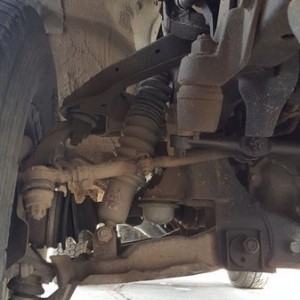

    Doesn't look like it. I used to own a 95 and it looked the same way. Check for spacers by the upper ball joints, it will look like a thick as heck piece of Metal between the arm and the caliper assembly. Those are popular on the older models like that. It just looks like you're sagging in the rear maybe an inch or so. The smallest lift kit they make for that car is 3"

    cbd10c6895d45ebb741580b46d1768c3_00b67c4555ed6f2282f6d454083b259dc8ff56b8.jpg see, mine sits the same.

    I have absolutely no earthly idea. But if you look up where your suspension is on the front end, like in the pictures youve shown, and there aren't any spacers, then you don't have a lift. I really doubt you've got a suspension lift on it man, in my opinion redoing all of the suspension just for an inch or two would be rather pointless.
