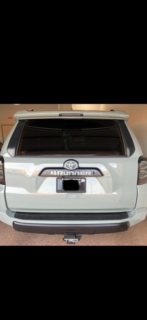

    What is the best method to remove the black badge overlays on the exterior without damaging them?

    Heat gun, a non marring pry tool, and lots of patience.

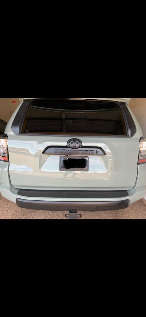

    Thanks FN. As far as trends, I'm so far from trendy. My wife just took delivery of a new nautical blue TRD ORP. She likes the OEM wheels and silver valance so I suggested she ask to not have the black out kit put on. I thought it was dealer installed? Either way, the outside emblems are blacked out.

    Heat gun will melt the thin material used to make the overlay. I melted my “Limited” on my Tundra when debadging. I moved the heat gun faster when removing the rest of the emblems.
    Didn’t try this but I suggest using steam to remove overlay adhesive.

    I used my hairdryer rather than a heat gun, there’s less of a chance to burn or melt anything. Then, as others have said dental floss, and I used rubbing alcohol on a cotton pad to clean off the leftover sticky. I didn’t break any of the plastic badges, they’re in a ziploc bag should I ever change my mind.

    Take fishing line and do a sawing motion and it will come right off. I wouldn’t use a heat gun

    I was hoping to remove the black overlays rather than the whole badge. Buying all of the exterior badges is more than I want to spend unless my wife demands otherwise. Guess they will stay put for now. I appreciate everyones help!

    I just removed my black overlays this morning…50° in the garage. I cut a slice in the fat part of the letter with an exacto knife then just inserted a nylon pry tool between the overlay and the chrome letter and just worked them off. Took more time to remove the glue off the letters than it took to remove the overlays then installed body color overlays
