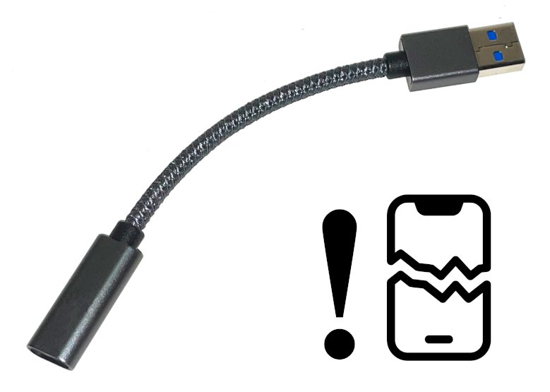

    So here is what the adapter looks like:

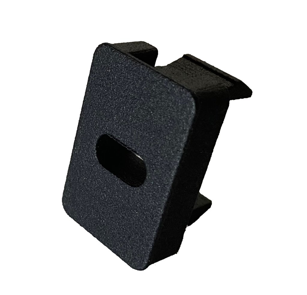

    I had it 3D printed in Nylon using SLS. I chose SLS for the quality (no layer lines visible) and Nylon for the durability. The material, "MJF Nylon 12" has a "Heat Deflection Temperature" of 175°C. I know cars get pretty hot in the sun but I've never seen water boil in them, so I think that should work. The 3D printing company offered black dye, so I had them do that. If you want, I think fabric dye for synthetics should work as well (you could add some flare with a color of your choice).
    Here's what it looks like when printed:
    I made the hole a little small on purpose to account for variations in tolerances. So some hand filing is necessary to finish the part. It took a few minutes and I left it very snug. I might glue it later, but for now it is just friction fit.

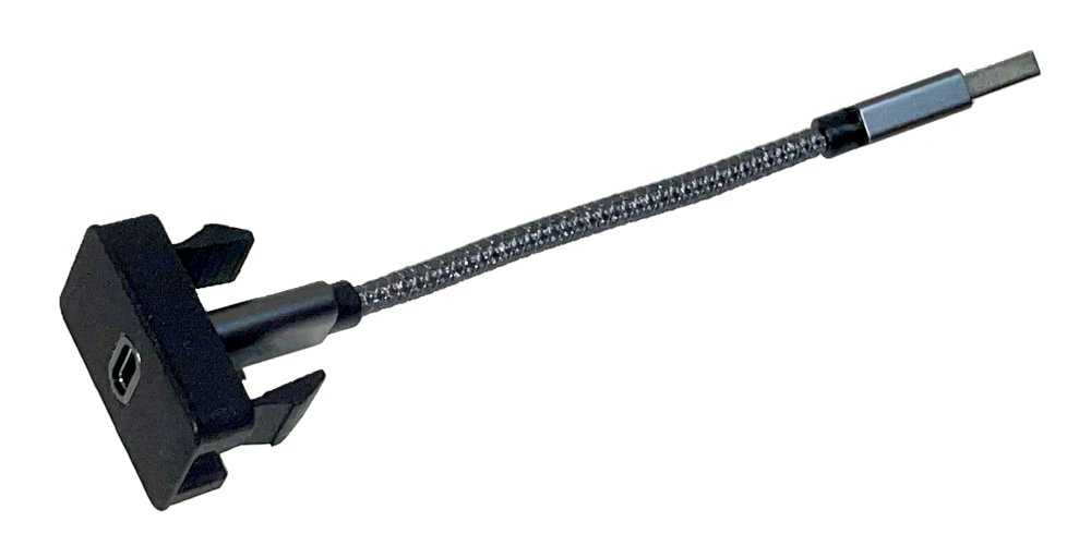

    Here is what it looks like in place, sort of.
    The clips are pretty loose. I think I might try using a heat gun and bending them out a bit. But the main force is pushing inward and the clips keep it from pulling out. So I don't think it will be an issue.

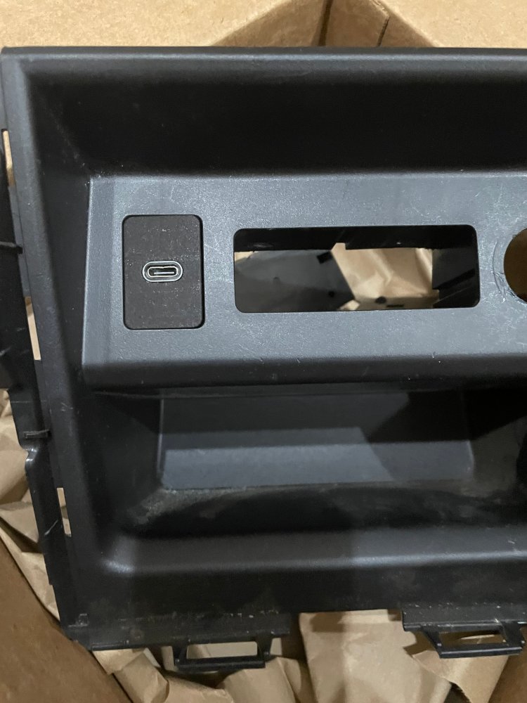

    The shelf is the version used in the higher end trims, so that is where the normal USB/AUX would be located. Yes, the idea is to remove the normal USB/AUX from there (which is a pain), and hide it behind the panel with the adapter plugged into it. That way the change is completely reversible.
