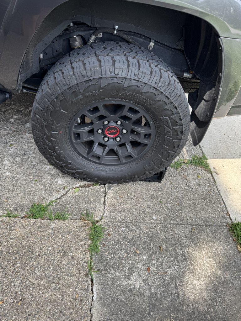

    I have a 21’ TRD ORP and a 2” Icon lift in rear. Rear wheel-well gap with 33” (285/70r17 Falken Wildpeak at4w C-load rating on TRD Pro wheels), appears much taller than the 33” tires. The top of the tire to fender flare looks almost over exaggerated.
    1. Can a 33” AT tire fit without the 2” lift in rear and just mud flap deletes on stock rear height?
    2. Can I fit a 285/75r17 AT tire on my TRD Pro wheels with this same lift and no additional trimming or modifications to the rear wheel well?
    Ultimately trying to decide if I want to stick with my 33” tires, can I lower the rear to lower center of gravity, or if I keep the 2” lift in rear can I go up to 285/75r17s and have greater ground clearance.

    You can fit 33s box stock
    The rear wheel well will take 33s without rubbing in the rear, its the front you gotta worry about.

    In the back you can do anything really. Is the front where the battle is at. Good luck.
    jaigo[OP] likes this.
