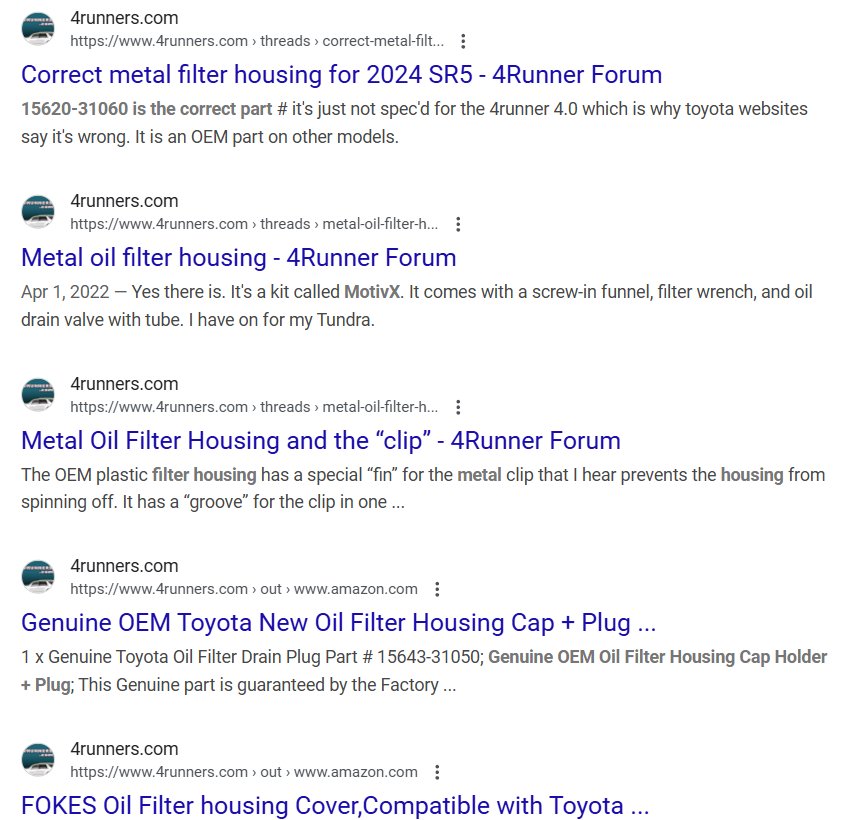

    Hello All,
    Looking for some advice.
    I had alot of issues with the plastic oil filter housing getting stuck. First time around i thought it was done by the dealer (it was under warranty) and figured they just over torqued it.
    Then the second and third time it was stuck as well, even when i did the oil change, i use two different torque wrenches so i am confident it was not over torqued.
    This cost me two runs to my mechanic where he had to use heat to get it off. Inconvenient, plus the added risk of having to use heat in such a tight area.
    He replaced it with an after market metal one, he did not transfer the old stand pipe and spring as the aftermarket came with everything assembled. I did keep the original.
    No issues since then, however recently came across some youtube videos and more than one of them has said the after market oil housing is a mistake as the spring is not calibrated to what Toyota wants.
    So i'm thinking to swop out again for the Toyota metal housing (part code 15620-31060) and use the spring and tube from the original plastic filter that came with the truck.
    Only problem is, again a few trusted people are saying as soon as the spring is taken out of the original filter, it's no good.
    Thoughts? Is it ok to swop the stand pipe and spring?
