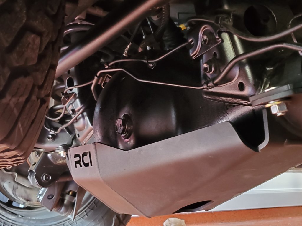

    Yeah seems like the rear is not so much needed. I ended up doing it anyway when I regear and just decided to do the whole thing at once.

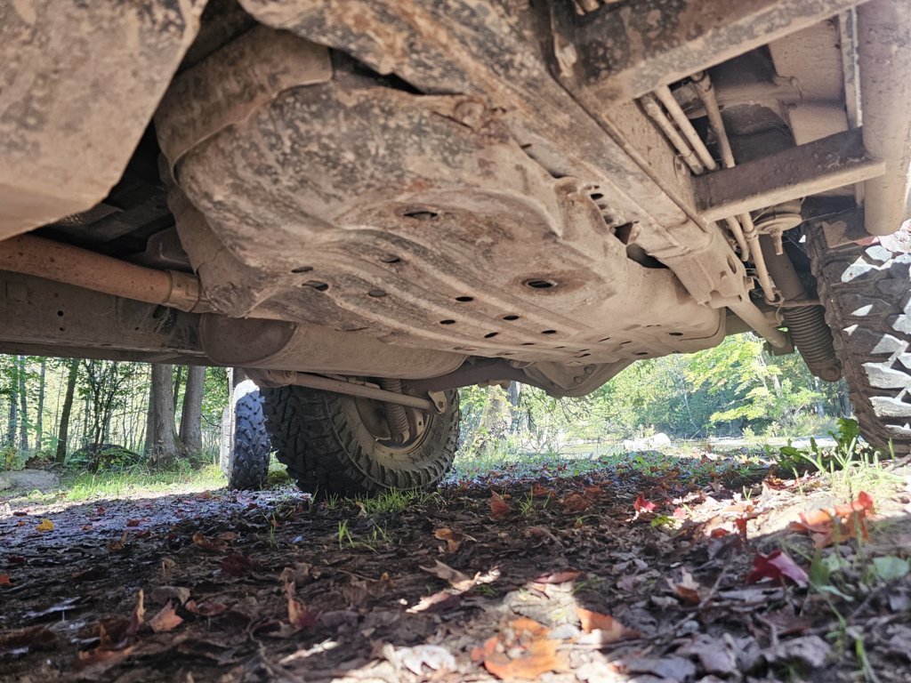

    Having neither, I'd say that one can get through quite a bit without them. If you use some finesse, the rear diff should hold up fine.
    The OEM fuel tank skid can handle a decent amount of abuse, as well. But, after a few years of moderate wheeling, mine is pretty banged up, and probably due to be replaced by something a bit more substantial.
    I'd say that, if you plan on dragging the fuel tank over boulders on a regular basis, go get a good aftermarket skid. But, if it's a matter of "just in case", the stock fuel tank skid will get the job done.
    For grins, here's what my fuel tank skid looked like at the end of last year's "wheeling" season.
    ChessGuy and Bknight21 like this.

    That's exactly how my gas tank skid looked after I was high centered with all four tires off the ground haha
