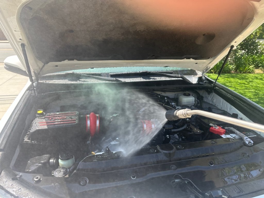

    Simple Green and water. In my case deionized and pressurized. Don’t be scared. Your engine bay is not sealed from exterior water.

    On the way back from every wheeling trip, I stop by a coin-op car wash. For the engine bay, I use the high pressure rinse setting but without pulling the trigger, so water comes out at lower pressure. Nothing needs to be covered. The alternator can take a good rinse with no issues. In fact, if the alternator got mud in it, it's better to rinse it out. The battery should be washed thoroughly to flush away any sulfuric acid that may have spilled out from off-roading.
