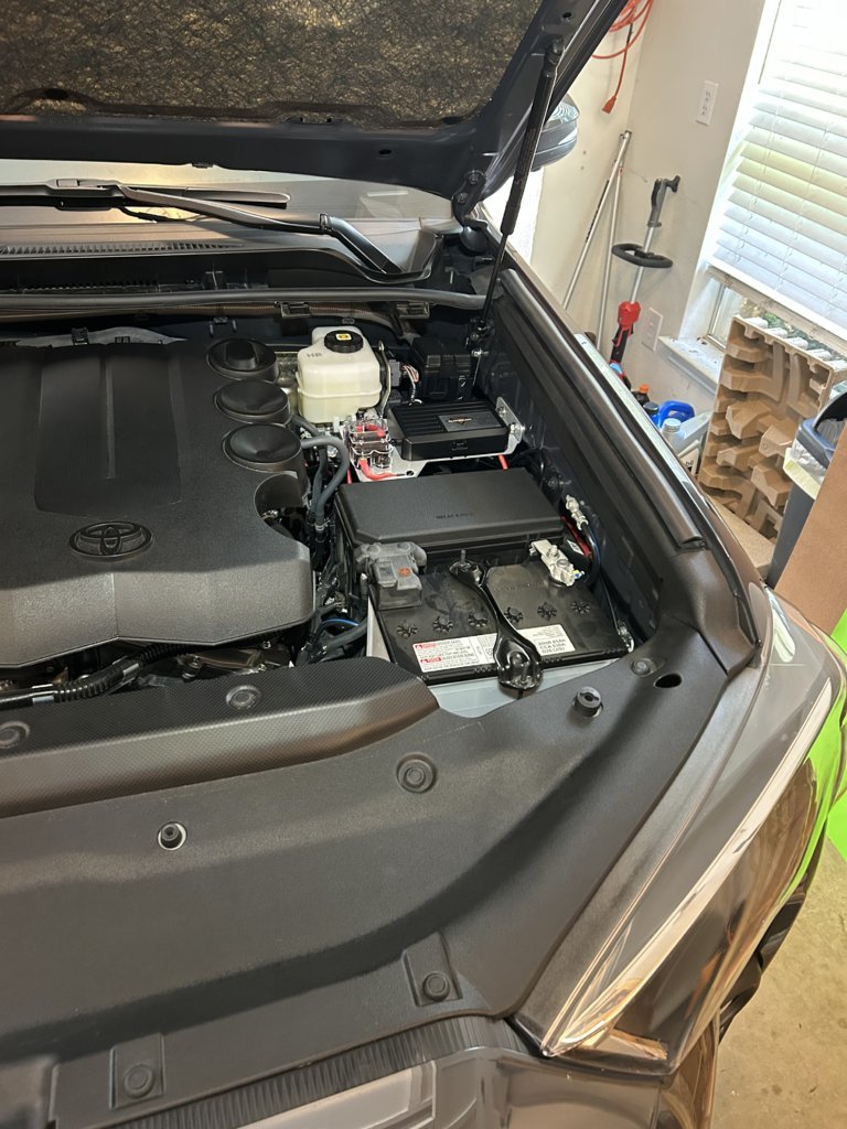

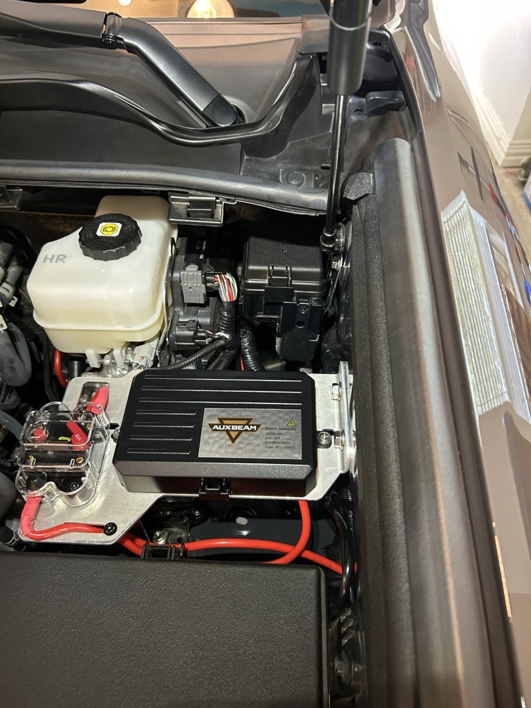

  11. Aug 7, 2025 at 1:20 PM
    M1220410
    M1220410 [OP] New Member
    Oct 17, 2024
    #43420
    25
    Scott
    Keller, Texas
    2024 Underground 4Runner ORP
    Sherpa Crestone Sport roof rack, Black Rhino Etosha wheels, Morimoto XB tails gen II smoked, El-cheapo Ebay black valances.
    Installed, but not connected yet…

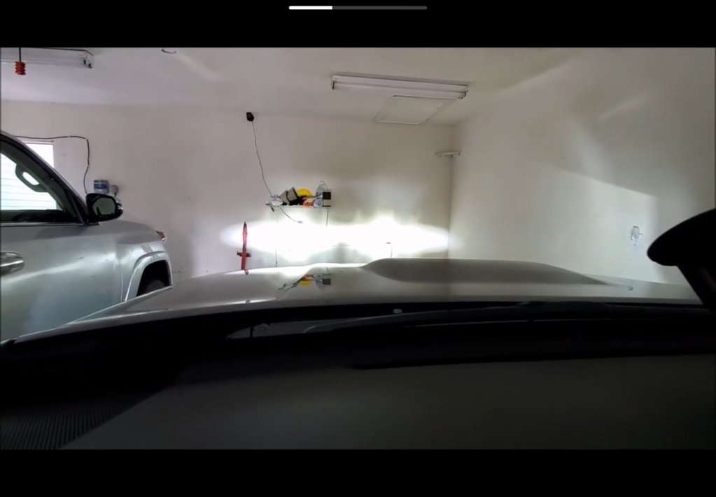

    Interesting!
    Makes sense that they might tweak the lense shape knowing that it would be a DRL going forward. Once I get the switch panel hooked up, I was going to buy (or possibly make if I can figure that out), a wiring harness and two Nilight LED bulbs. See what happens. At least it won’t be too expensive…
    I like your idea though. Is yours behind the grille?
    here is a screenshot from the LionRunner video - I wonder if that is the star pattern?
