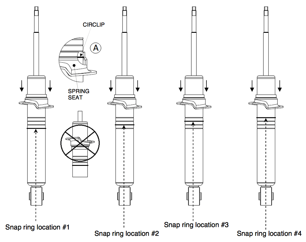

    Hey guys.. Green thumb mechanic installing the bilstein 5100s front and back.
    Backs, piece of cake.
    Front was a little tough. Selected the 1.75in front lift, completed it, took it for a spin around my block and the ride was awful. Felt stiffer then all get out and if I hit a little bump, it would bounce aggressively maybe an inch up and down. Looking at the lift, the springs looked way to compressed and the 1.75in looked way to high so we took it all apart and set it to the factory height and put it all back together. Took it for a ride and much better, helped the front nose dive tremendously and it was nice and smooth. But… after selecting the factory height, it still gave the front end a pretty noticeable lift..
    Is this normal?! I’ve read just about every post there is on this lift and I’m kind of coming up blank.
    Thanks 4Runner fam.
  2. Sep 10, 2022 at 3:11 PM
    4,814
    Are your lower spring perches upside down? Like the one that's X'd out?
    Thatbassguy and Piney like this.

  5. Sep 10, 2022 at 3:32 PM
    4,814
    It's a fairly common error.
    SlvrSlug likes this.
  6. Sep 10, 2022 at 3:34 PM
    Adlerk00
    Adlerk00 [OP] New Member
    Aug 20, 2018
    #6820
    11
    Kory
    2020 TRD Off-road Premium
    Thank you 4Runner dudes. You are indeed correct. God damnit. I’m gonna go hide in a corner for a couple of hours then get back to it.
