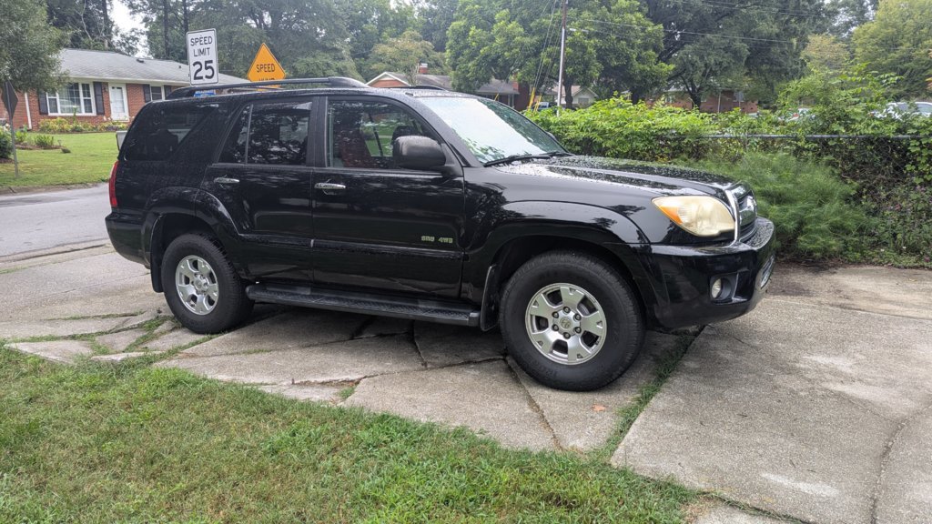

    PXL_20250812_133630064.jpg I bought my 4Runner in April, and the sunroof was inoperable. I tested with a hose to check for leaks and everything was dry inside. I made it through most of the summer through numerous thunderstorms and washes with no leaks. Starting early last month I noticed a small amount of water on the driver's floor mat, and it's gradually become worse. Before I start trying to find where the problem might be, can anyone offer me some advice? I've watched videos of removing the headliner to get to the sunroof to repair it, but no mention of clogged drains, etc.
    Thanks in advance.
