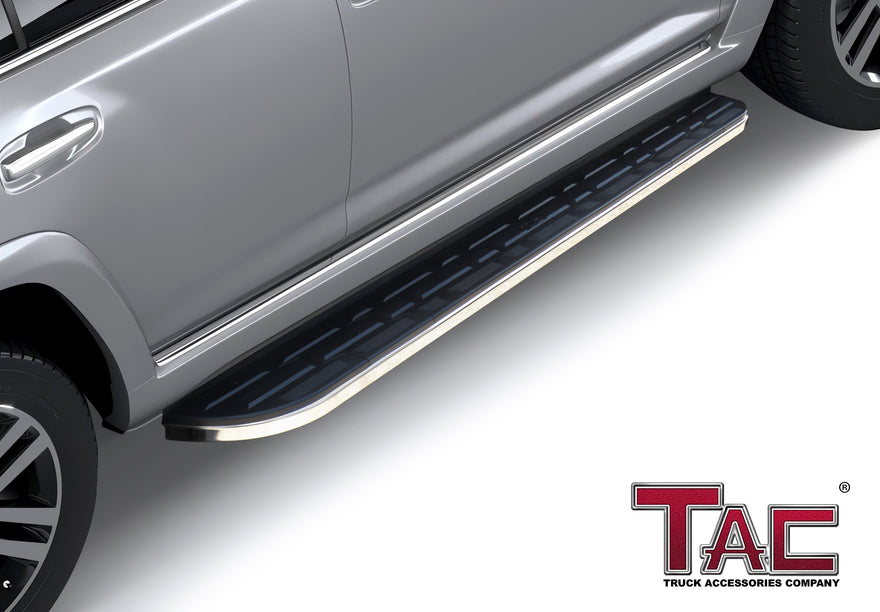

    I think what you have is considered a 5.5" step. I assume they measure the entire width of the step. Unfortunately about 1.5" of it is tucked under the rocker panel which doesnt give you a lot of step to use when you step out. You barely get your heel on it and its easy to slip off. These below are what appear to be the widest i can easily find today.
    https://www.tacautoparts.com/collec...-nerf-bars-step-rails-aluminum-black-off-road

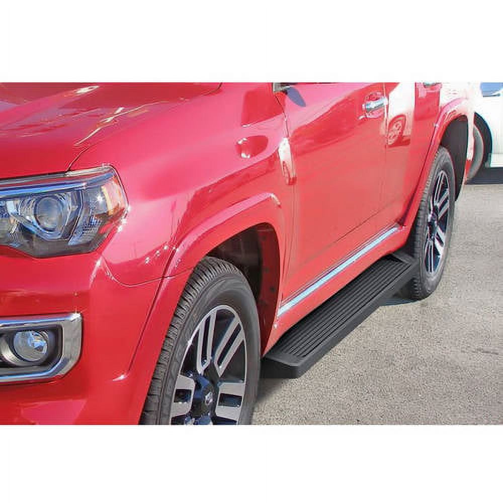

    Here is a 6" wide running board
    https://www.walmart.com/ip/2010-201...Edition-6-Matte-Black-iRunning-Board/55449980
