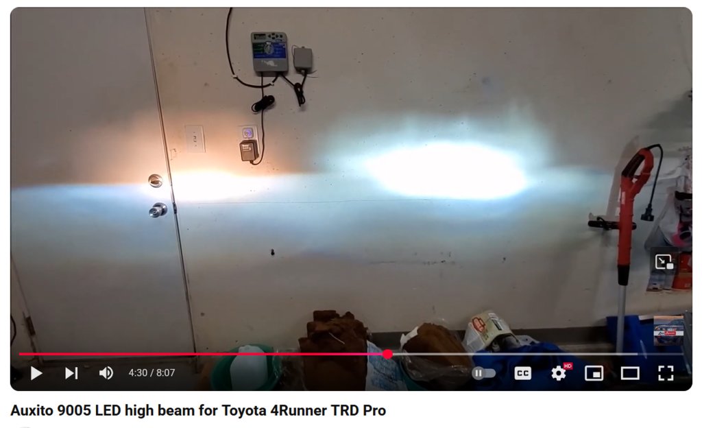

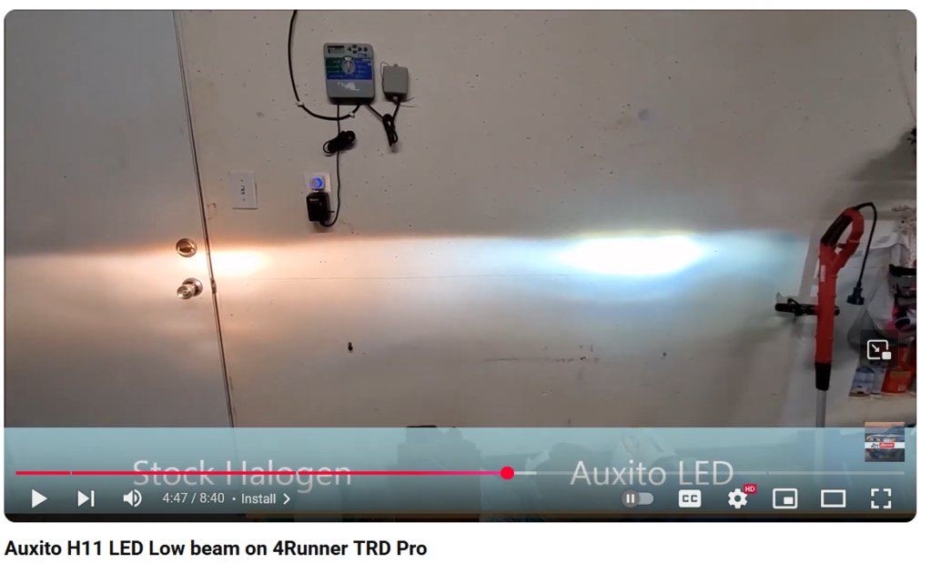

    Auxito is pretty decent. I have installed this on a 2019 TRD Pro. Here a comparison shot(s) stock halogen Low beam & highbeam vs Auxito fanlessLED.
    (Pic after low beams upgraded to Auxito low beams. Comparing stock halogen high beam vs LED high beams.)
