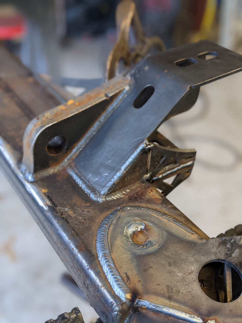

  13. Jun 10, 2023 at 10:48 AM
    BashFab
    BashFab [OP] Maker of Things
    Dec 9, 2022
    #30016
    46
    Chad
    Columbia, SC
    2018 Black XP
    BashFab eco front bumper, hybrid bolt on rock sliders, rear swingout bumper, locked f&r, 4:88's, 35x12.5, full Rci skids
  14. Jun 10, 2023 at 2:18 PM

    with the hitch what is the towing capacity for the bumper and what is the turn around time for the build?
  16. Jun 10, 2023 at 10:01 PM
    BashFab
    Dec 9, 2022
    #30016
    46
    Chad
    Columbia, SC
    2018 Black XP
    Tbh I can't put a tow rating on it. It's "off-road use only" however I would put my fabricated hitch against 3 factory hitches stacked. The way I've designed this bumper to bolt on I have no doubt you will tear the frame off the truck before you do anything to the bumper/hitch assembly. I add in an additional 4 bolts per side for a total of 8/side, 16 total. My added bolts are all 1/2" grad 8 which is larger than the factory fine thread bolts. My lead time after vehicle drop off is around 4 weeks for this one with similar swingout configuration. Less if you're just doing the lower bumper with no swingouts (can always be added later on)
