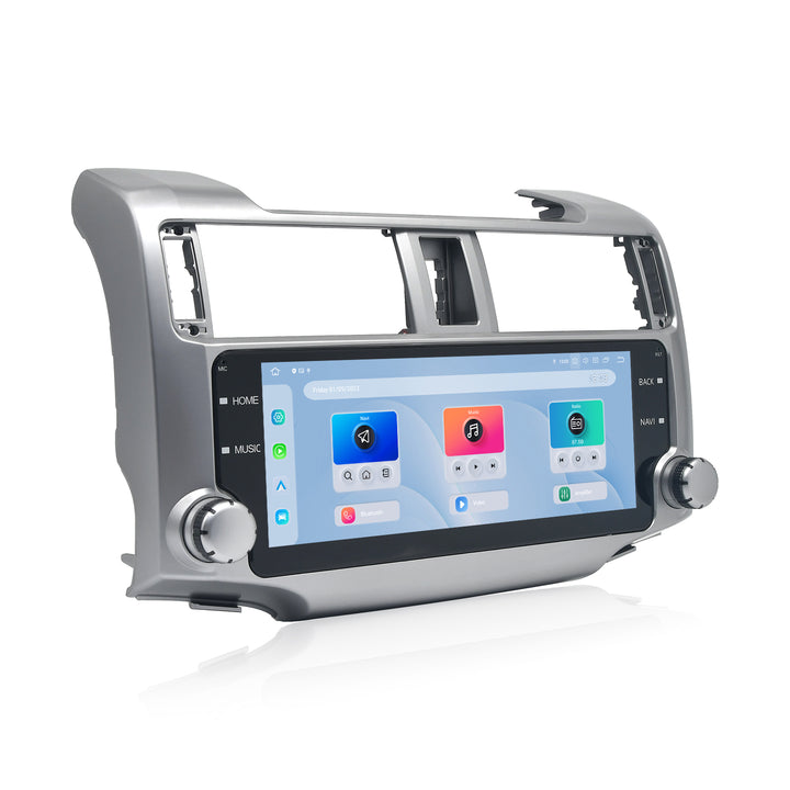

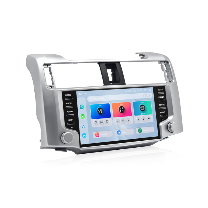

  16. Apr 2, 2026 at 12:55 PM
    1,539
    Yeah thats it
    https://www.hamiltonmotorcompany.com/products/2014-2019-toyota-4runner-apple-carplay-conversion-kit
    Dasatia has a few different types
    https://www.dasaita.com/collections/toyota-4runner-car-stereo
