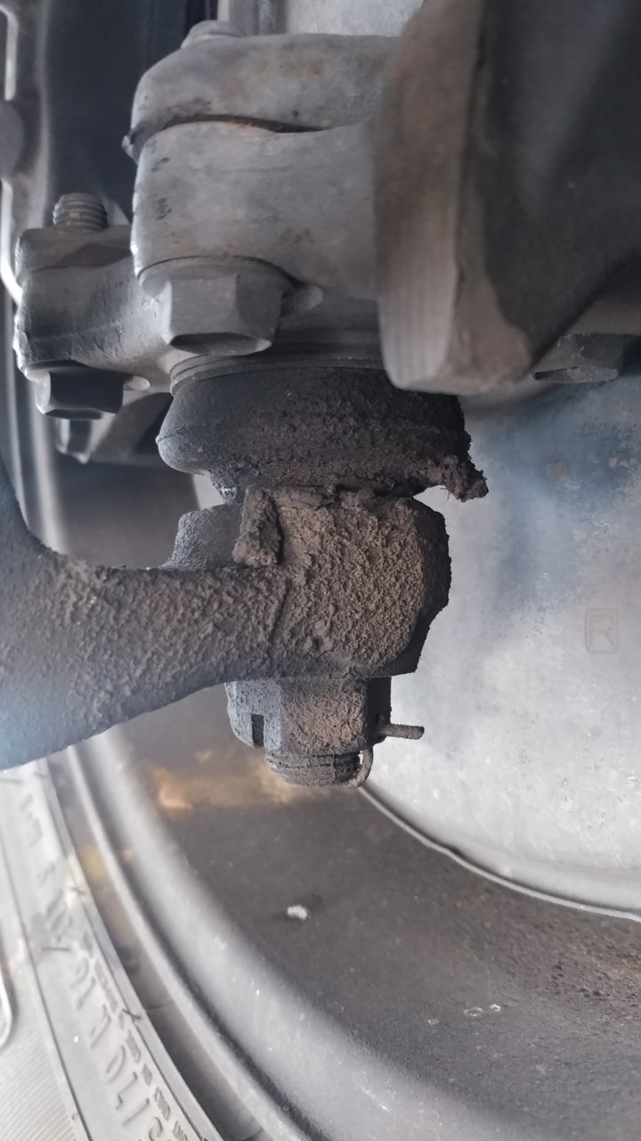

    Driver Front - LCA
    Seems fine, boot intact, no play
    Driver Front - UCA
    Driver Front - Top End Link
    Bushings worn, but not cracked
    Driver Front - Bottom End Link
    Driver Front - Stabilizer Bar Bushing
    Could use replacement, but not cracked
    Driver Front - Steering Rack Bushing
    Natural seam drooping, likely cracked internally - Replace
    Driver Front - Tie Rod End
    Joint boot split, play unknown - Consider replacement
    Passenger Front - Tie Rod End
    Passenger Front - Stabilizer Bar End Link
    Passenger Front - Steering Rack Bushing
    Worn, but not cracked
    Central Steering Rack Bushing
    Obliterated - Replace
    Front Passenger - LCA
    Joint boot intact, no play
    Front Passenger - UCA
    *** Skipping all rear bushing because they look fine ***
    Front U-Joint
    No zerk fitting...?, tiny play but it feels like its from the fork not the U-joint
    Rear U-Joint
    Zerk fitting, but grease wouldn't go in, no play

    So, it's hard to tell how badly the ball joints need replacing. To me, it looks like most have leaked out a good deal of grease. Those boots may be ok, but who knows how much grease is in there? At 250k miles on my car, I simply replaced them all. The old ones all "felt" tight but for me, I felt I may as well replace them now. They don't last forever and when they go bad...you're looking at a very bad day. And with 250k miles on them...how much more life can I expect out of them?
    I figured I should check the wheel bearings while I had the steering knuckles off and they indeed are huge. Mine spun with no issues at all...so I didn't go the route to replace them. A wheel bearing gives you a heads up before it goes wheel-fell-of-the-car bad. Even so, there were seals on both sides that were bad that would let dirt in and I'm glad I caught those and replaced them.
    Regardless, none of that will fix the issue you have I think. Just figured I would comment since you posted all those pics.
    Gotta be something in the drive line.
    SlvrSlug and ruiz4251 like this.

    All the boots you posted are dry as a bone, i would start addressing them as soon as possible, just because it seems like the boot itself is intact does not mean they are ok, this is just my opinion.
    negusm likes this.

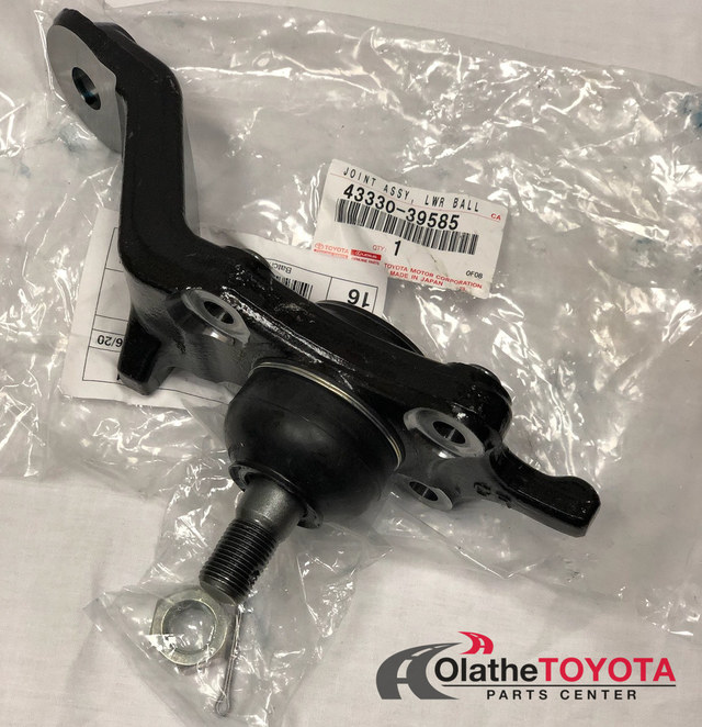

    Ok, I'll probably go ahead and do the lower ball joints then too; they're not too expensive, and they even have greasable ones looks like!
    I did UCAs on my taco where the boots were completely torn through, so I'll probably wait until I see something definitively wrong on those.

    I recommend Toyota Ball Joints. The aftermarket ones are not built the same. There's a reason why aftermarket ones are cheap.
    $120 vs $27
    Meh

    Well, $105 if you go to an on-line Toyota dealer. I know it's hard to swallow the price difference, but I just can't see a $27 part like that getting any sort of decent QA. $ per mile is usually better for the OEM part.
