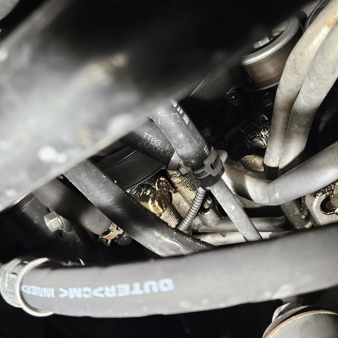

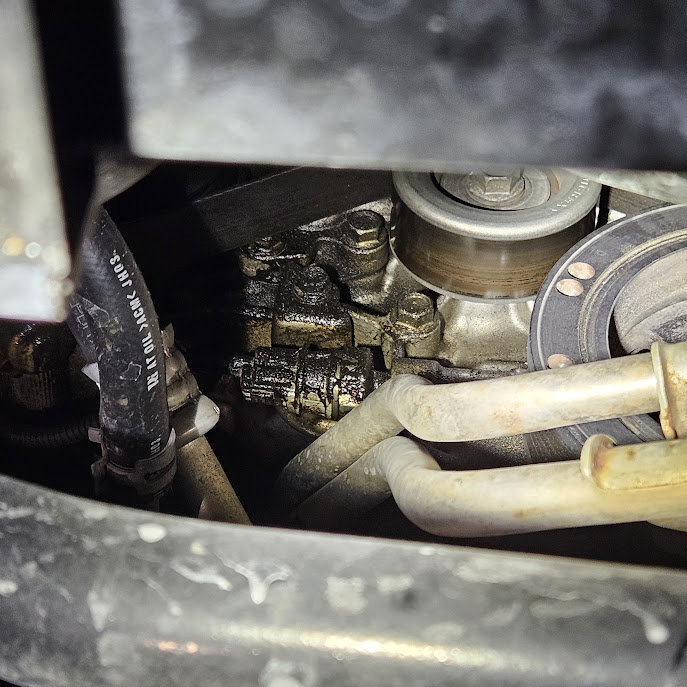

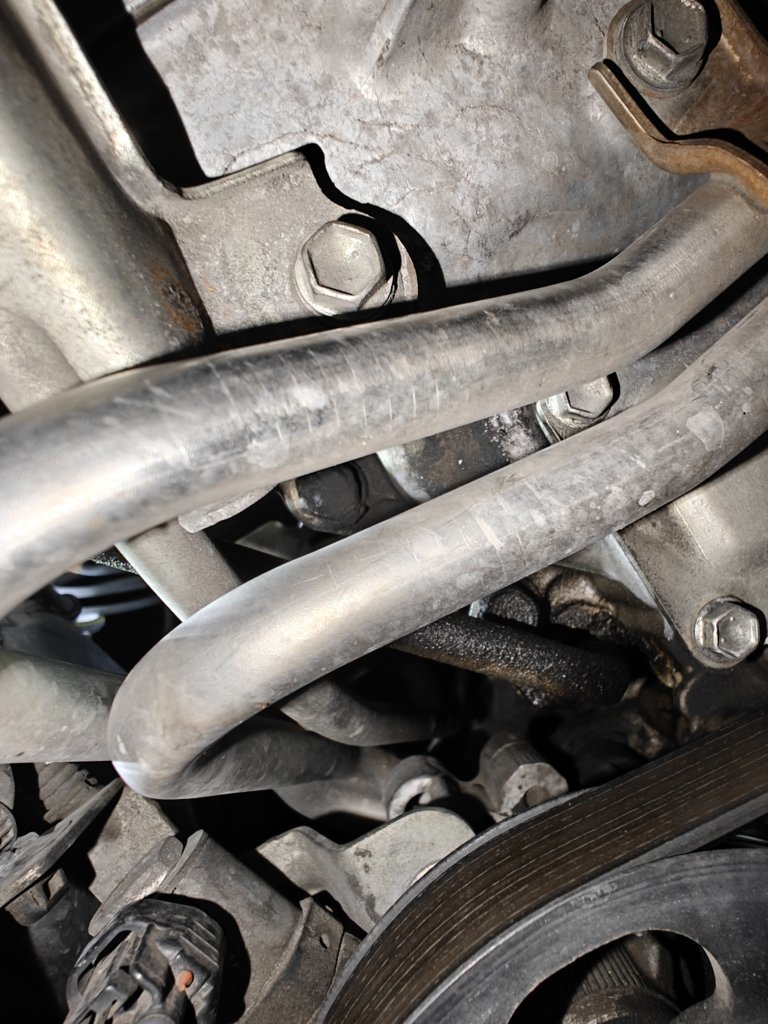

    went under our 2019 SR5 to change the oil and noted evidence of a leak. got pics from the front and back...any ideas where this one is originating? looks too deep for me to get at...wonder how much it's gonna hurt at the shop...

    Clean it and then see where it's originating.
    Like this we are only shooting in the dark.
  3. Jun 24, 2025 at 8:34 PM
    3,096
    Looks like timing cover leak, which often develops near the power steering pump. Removing the timing cover to re-seal it will be labor-intensive - budget about $2k. Alternatively, the shop can temporarily remove the power steering pump, clean the area, and apply sealant on the outside. The 2nd gen Tacoma folks report good success with this method.

    That's for 1GR or 2GR? The latter is typically an engine-out job at the dealer.
