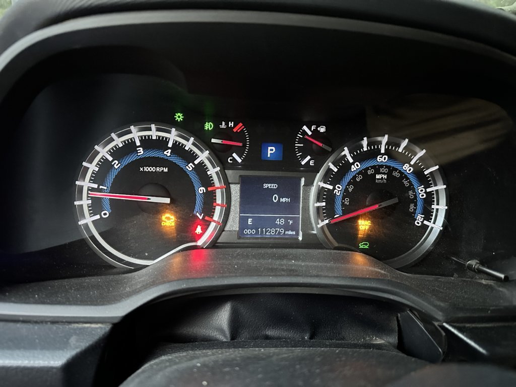

    In Polebridge Montana. Got a check engine light with these codes, reset codes. Rig stalled shortly after. Ugg. 19 trd pro 113000 miles. Recently cleaned MAF, throttle body, PCV new.
    going to look around under hood. Limited WiFi but will be here for a bit.

    Damn. It was 2pm when the OP took that picture and it was 48 degrees. It sucks he's having CEL problems, but I'm jealous of that cool weather.

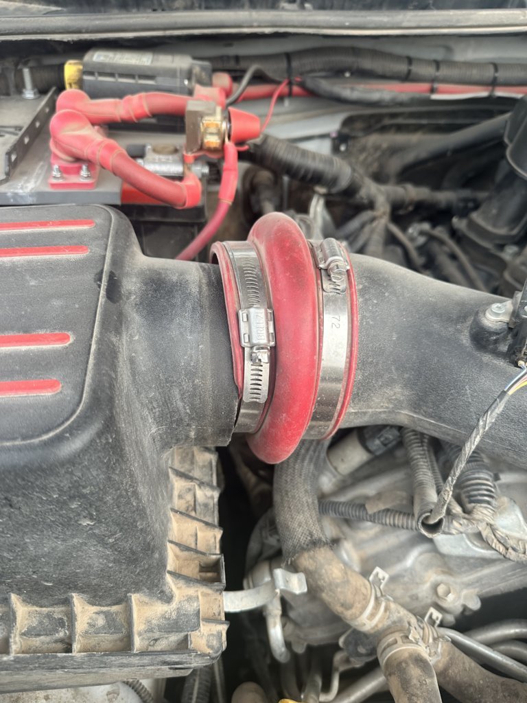

    This picture here is very telling. Look at the clamp and rubber piece - I see a big gap here from left to right. Smack the SOB:smack:

    Hopefully that boot wasn’t disconnected. It would not cause the OPs lean mixture, but would let a lot of dirty air enter the engine.

    Looking at the pic of the botched intake install, the MAF sensor is probably filthy. I would buy a new throttle body gasket, guessing the stock was reused after cleaning the TB. I would clean everything (inside) after the air filter.

    TuRD intake box is kinda crap, easy to over tighten the clamp and collapse the thin plastic where the intake tube mounts. Main reason mine went in the trash.

    Loose battery terminal can cause a stall. The intake coupler leak can't, because it's upstream of the MAF sensor. However, check the other end of the intake tube for a leak where it connects to the throttle body. When the engine torques in its mounts, it can pull away from the intake tube. The intake relies on the red rubber couplers to flex like an accordion and take up that distance change.

    Isn't that red silicone gasket supposed to clamp around the air filter housing outlet instead of just hanging around next to it?

    I’d mooch a screwdriver and fix that intake boot so you’re not sucking dirt into the engine.

    Did that as soon as I saw it. Lucky I only drove a bit before it was found. Definitely going to keep it tighter and check it more.
