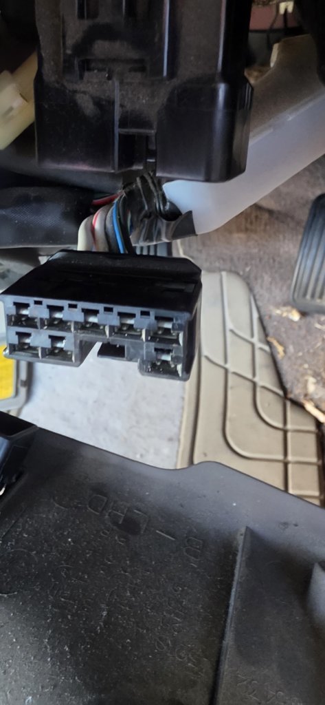

    So I'm getting power to the top left 1st and the top 4th pins. This is the ignition connection that goes straight to the key ignition.

    Nope. No lights, no radio, no HVAC, nothing. I think I've narrowed it down to tbe ignition switch selector.

    No headlights or tail lights. I have hazards, and dome lights as well as door lights. I replaced the Dome fuse and got the key indicator/ buzzer to work. I removed the ignition selector switch, and am going to try to clean/ potentially swap it out for a new switch.
