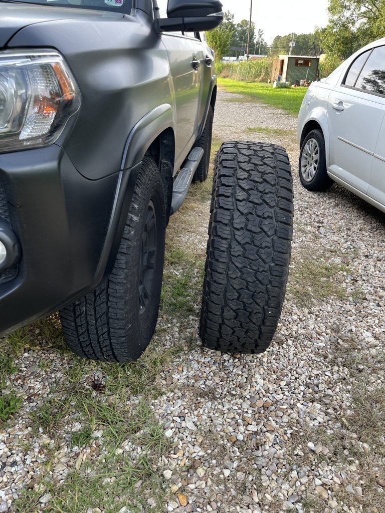

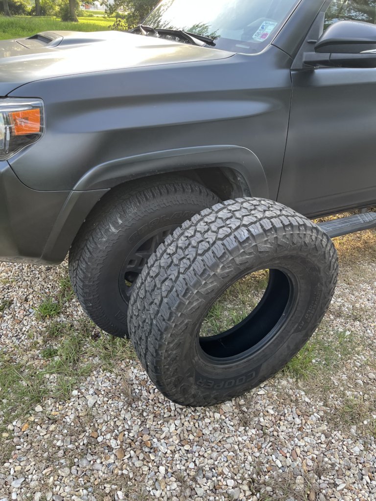

    Post some pictures!!!

    I dont have them on yet but will this weekend
