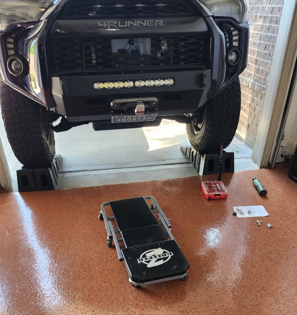

    I've had the polycuramine expoxy with the rustoleum floor paint and currently i have polyurea epoxy from a company that came out. The current polyurea is easier to clean and scrub i think. And i think it's holding up to the vehicles better.

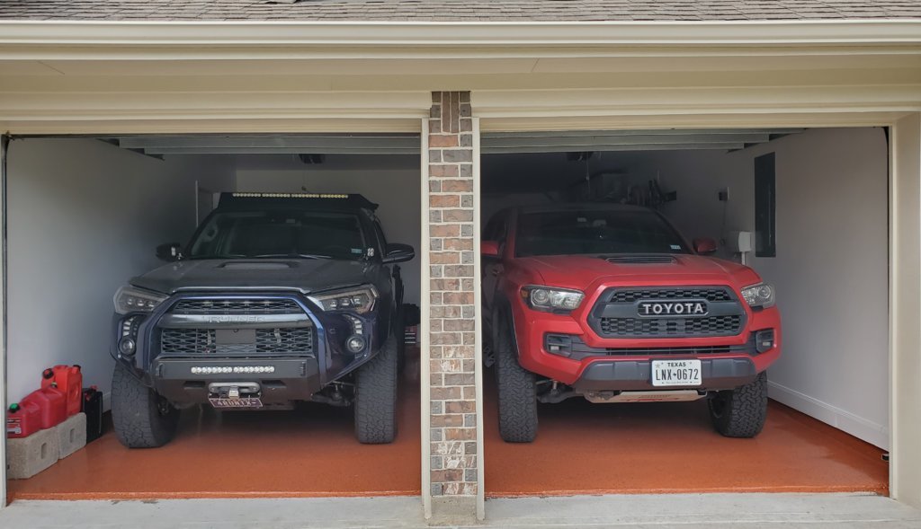

    Had my previous garage done with 100% solids 2 part epoxy. Like many other things, prep is key. A clean porous surface is required for long term reliability.
    For everyday use, I don’t think it matters much between epoxy and polyurea as long as it’s done correctly.
    The only disadvantage is slipperiness, however additives can be incorporated into the clear coat for grip.
    If this is a new slab it needs to cure. Moisture content needs to be checked before applying.
    Go for it. I’d like to get my new garage done one of these days.
