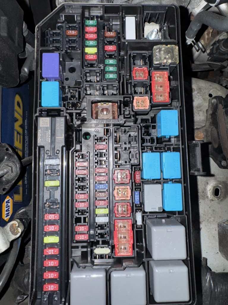

    Looking for recommendations on where to fuse my lights. I will be using the engine fuse box and the install video recommends the INJ position. I was considering though using one of the headlight fuses to have them on only when the headlights are on. Anybody else do this and what fuse do you recommend?

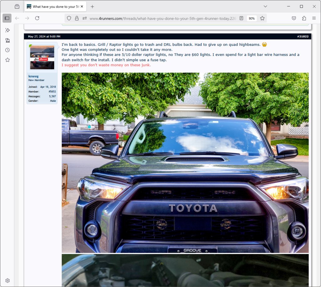

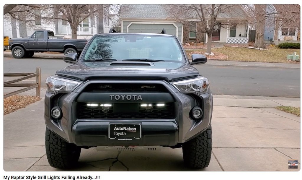

    That might be a better idea if you must install "raptor" lights.
    Mine only lasted few months since they were on when vehicle has power. LEDs start burning out.
    How it started -
    By the time I decided to put them in trash -

    My recommendation = don't install them, save your money.

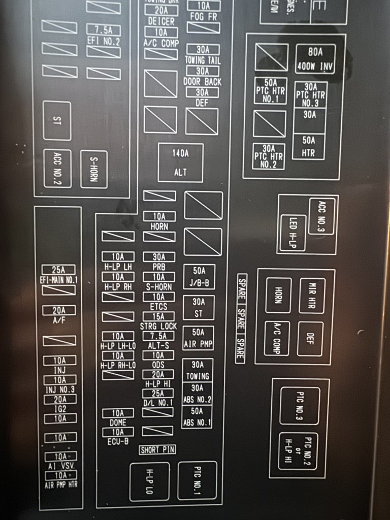

    I've had my Amazon ones in for over a year with absolutely no issues and love the look. I just wanted to see how they were without spending a lot first. Mine are powered by the fog light fuse at the top of your pic, if that blows the truck doesn't have any issues.

    Nice! The 10A fog FR? Ya ideally I would just want them on when the headlights are on if I go through with it....

    correct. but that's a personal preference of mine to have them on then, you could find another fuse that is on with the ignition, there's many of them. Just grab a electric tester to find it. The INJ fuse is fine but sketchy if a fuse tap blows, can leave you without a starting truck somewhere.

    The INJ fuse is for fuel injection. When the truck does periodic evap system self tests at night, lights tapped into the INJ fuse may turn on as well.
    The headlamp lo-beam or fog fuses are safer choices.
