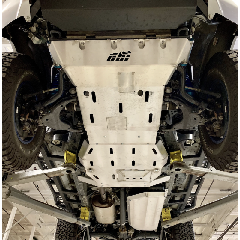

    So I have a stupid question. I swear my 2020 4Runner had a full size, thin aluminum skid plate under it that completely covered everything. Recently I went to see where something was dripping and behold my skid plate is no longer there. I believe the dealer took it off and never put it back. I'm wondering if anyone has the full skid plate underneath, or I am delusional?

    Yes it comes stock. Still have mine in the corner replaced with after market.
    Not a full skid but front engine.
  3. May 20, 2023 at 6:26 AM
    7,370
    Oem engine skid is 2 pieces. Steel, not aluminum.

    I have tried to sell most of my OEM take off but assumed the engine skids would not have much demand. People have them stock or replace with after market. Has anyone successfully sold the OEM?
  5. May 20, 2023 at 6:48 AM
    7,370
    The only buyer would probably be someone not interested in aftermarket, but tore up their oem. Could happen. The photo I posted above is from an eBay ad, they wanted $150ish. Some other eBay seller was asking $425. Right...

    21 Venture - just curious, what aftermarket skid plate did you put on your Venture. I have a 21' Venture also and have thought replacing the factory plate but haven't yet. Would love to have something that allowed me to reach the oil filter and looks better than the factory skid plate on the Venture.
  10. May 20, 2023 at 7:10 AM
    2021venture
    2021venture New Member
    Jan 15, 2023
    #30658
    900
    Todd
    2021 Venture
    I went with RCI. This was my first upgrade because of easier oil changes not needing to drop the skids. Also added a fumoto drain valve.

    Love the RCI's. Nothing but good things to say about fit and quality. Hardest decision I had was steel or aluminum. Time will tell if I would go steel next time wanting strength over weight savings.

    Nah, I had the really long aluminum skid plate that went all the way down. Oh well, guess I'm screwed.

    He didnt. If anything, it was two pieces, not one long one......
  19. May 21, 2023 at 7:16 AM
    7,370
    It's not. OP bought pre-owned, so it's an aftermarket that the previous owner put on if it's a "really long aluminum skid plate that went all the way down".

    I didn't even try to sell my OEM skids even though those looked new. In trash bin they went. Those aren't skid plates but thin sheet metal "engine under cover" which is only good against water/mud splashing and maybe gravel.

    I think the factory roof rails are same scenario. I removed them but can't imagine much demand for sale cheap or free. Most people have OEM or remove to replace aftermarket.

    They’re not thaaat bad. After all, the front plate is a jackpoint and holds the entire weight of the vehicle. Sure, they’ll deform with a hit, but deformation absorbs energy. They will also deform in a frontal crash impact, instead of creating a non-deformable structure out of the front end.
    Serious armor has it’s place, but the OE skidplates are a good balance that get you protection from one or two good hits, or multiple scratch-over-rocks situations. And you can do basic maintainance without needing to spend hours with a jack removing/reinstalling skidplates to put a squirt of grease in the driveshafts.
    They strike a good balance for most owners. Unfortunately Im at the end of the balance where I’d be comfortable with more stout protection in trade for reduced of frontal crush zones and more weight. But what really holds me back is r&r for maintance needs. That sounds like a pain in the ass with how heavy some of these armor options are.

    Access covers, one for oil drain plug and one for oil filter:
  30. May 27, 2023 at 8:24 PM
    6,150
    I wish they came with covers that would let you access the grease zerks for the front and rear driveshafts. All seem to require complete removal.
