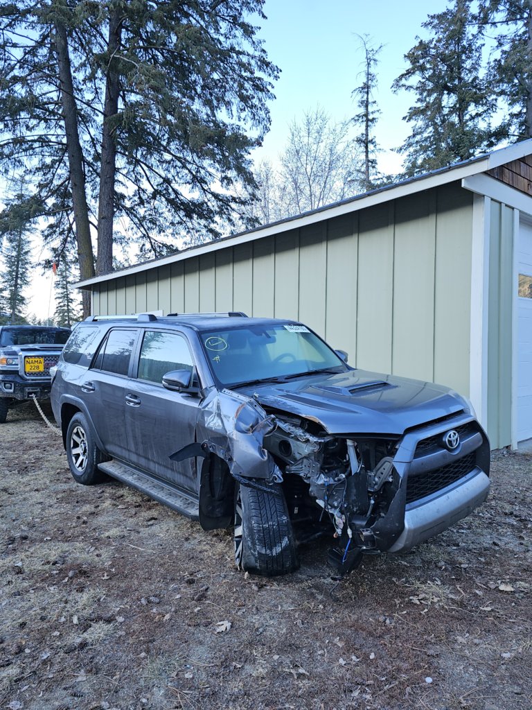

    We've replaced nearly everything in the front end (we bought it from salvage and fixed it - before and after photos attached for reference). See the list below.

    This clunk reminds me of a post I saw on another forum (when I was researching into SPC UCAs…) SPC UCA Failure

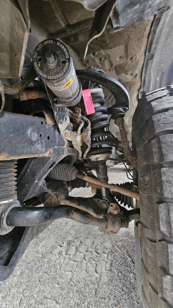

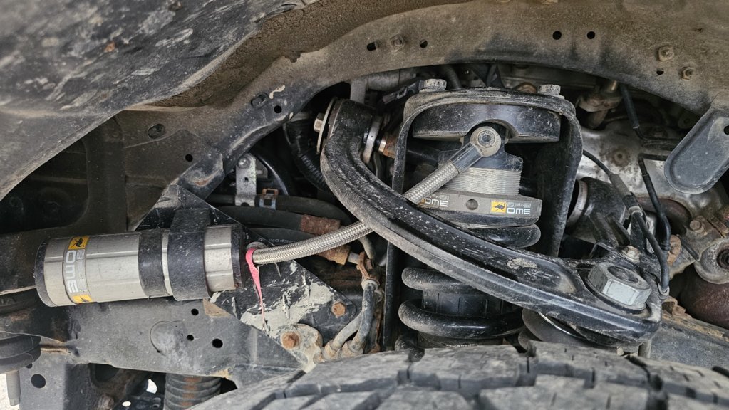

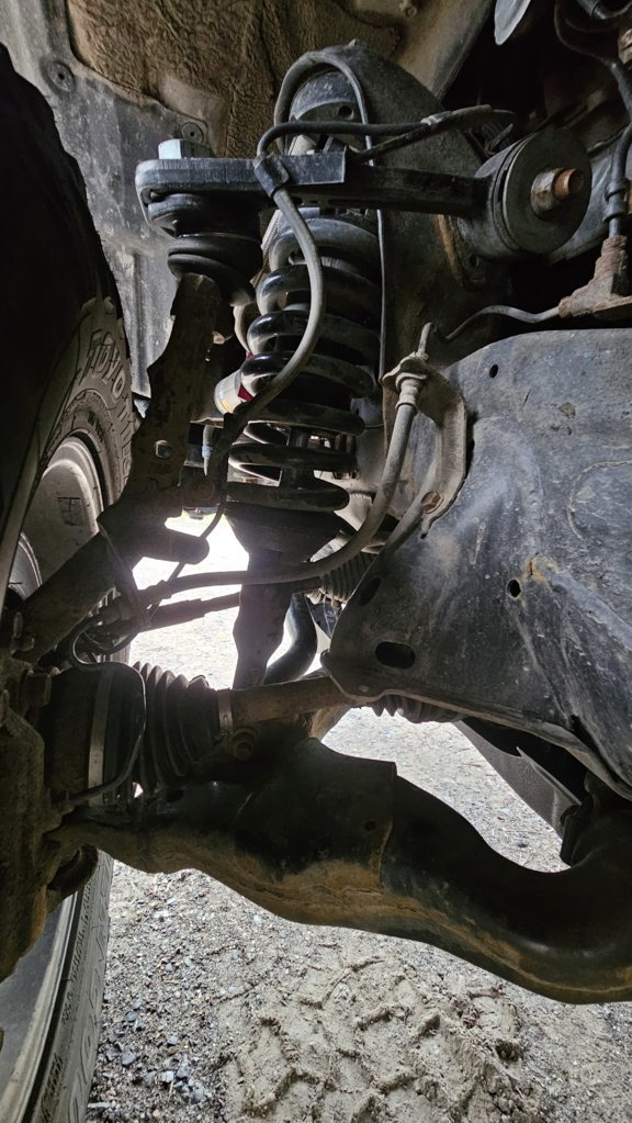

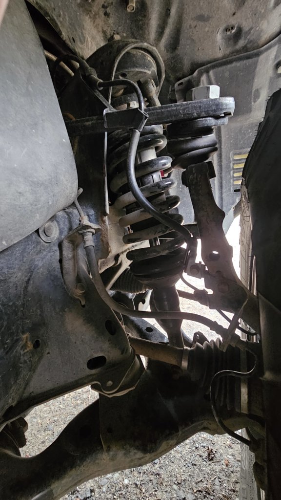

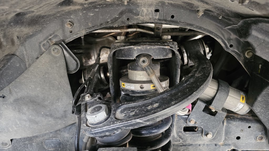

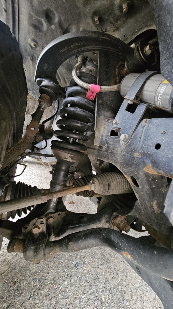

    Photos as requested:
    LH
    RH
    kolter45[QUOTED] likes this.
