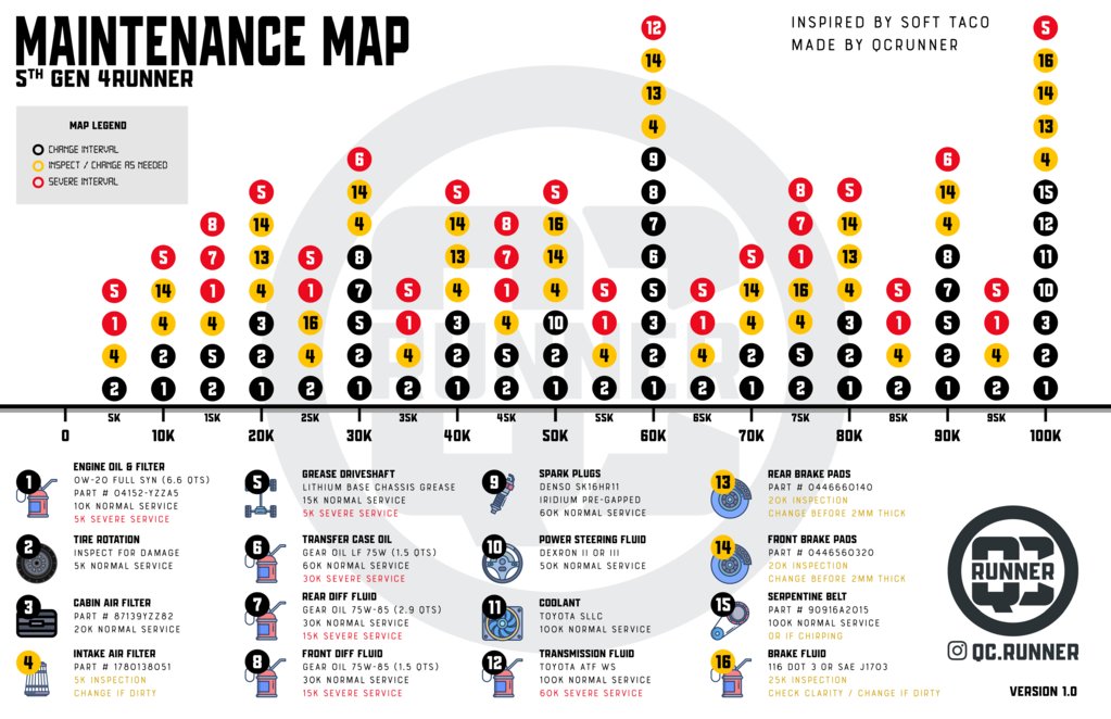

    Many of us follow this one here and Toyota Maintenance Manual as well.
    TrailSpecial22, TXKK626 and Sean[OP] like this.
