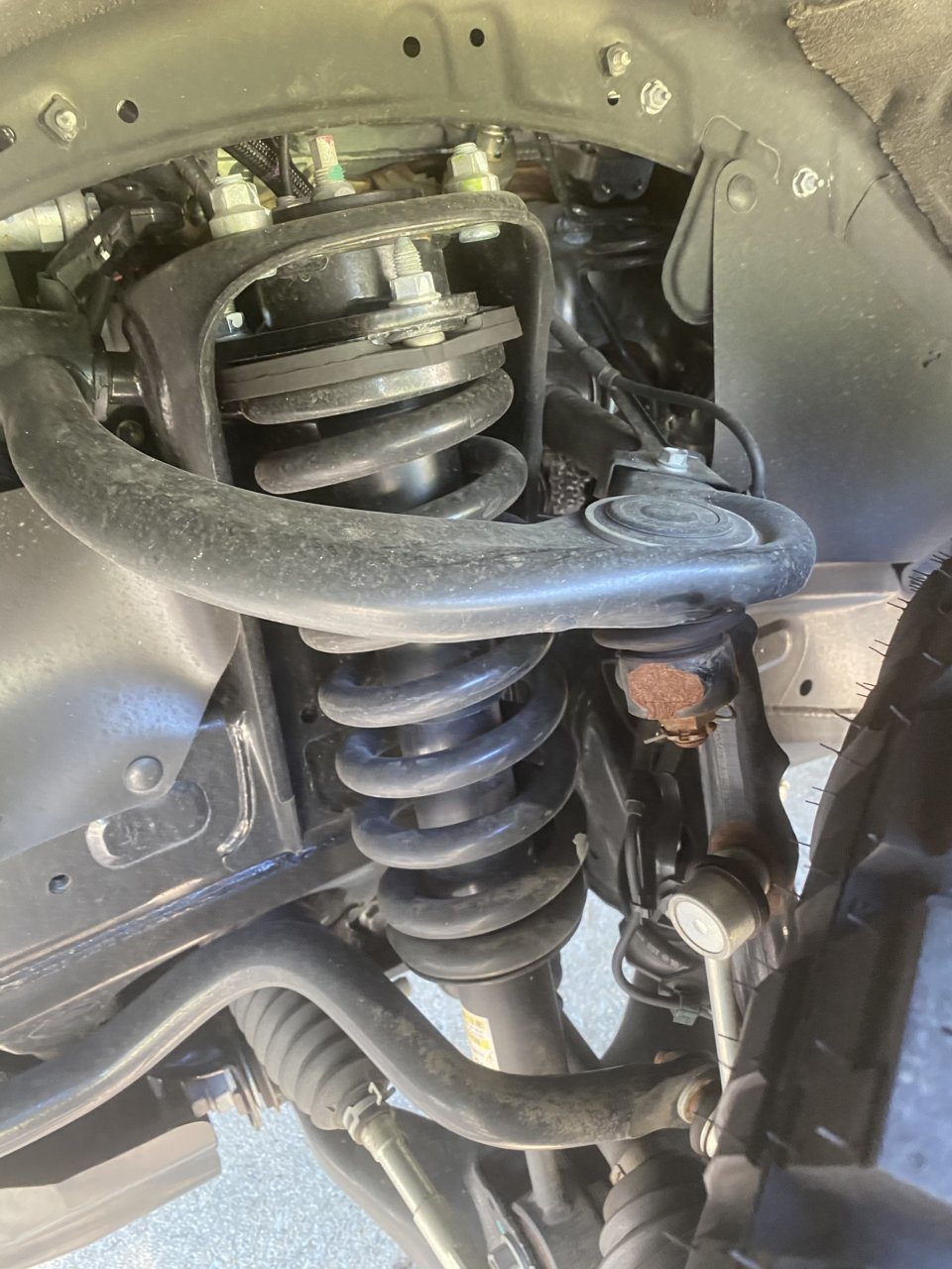

    20201222_095107[702]JBA UCA.jpg Welcome from Wisconsin! Floating... like on ice, is this the front end with a 'push' like feeling? Or is this the rear with a 'slip' type feeling? Either way, the amount of lift will have an effect on the feel of the ride. We have a 3"/2" spacer lift and the ride is good. We also put aftermarket upper control arms(UCA's) on to adjust the castor to where it feels more stable at higher speeds going down the road. An alignment is crucial after a vehicle has had any suspension work. The aftermarket UCA's allow for a caster adjustment that is more in the middle of the adjustment range instead of being 'maxed' out one way or another. Get alignment checked. The red pieces on the suspension are UCA's... on the pic.

    This is the most helpful group and I am so grateful for the responses. It has more of a slip feeling like I am on ice. Another comparison would be like turning a grocery cart
    I took it on 3 test drives for about 30 minutes each but none of those were on the highway. Driving around residential streets felt exactly like my old 4Runner but I wasn’t going very fast. Here is a pic. I have an appointment at the dealership next Tuesday.
    Thanks again for all of your help

    Is that castle nut rusted to hell or is it some type of illusion?
    Anyways, looks like it's indeed the stock uca with a spacer lift, aka the dealership special. Talk to them and let us know how it goes.

    No kdss, can see the sway bar end links in the pic he just posted.

    There’s lots of rust in several places.

    That's crazy for a brand new truck. I think the rust area around the sway bark link is normal, the rest is worrying though. That castle nut is especially bad.
    OP we need some more pics in this area:

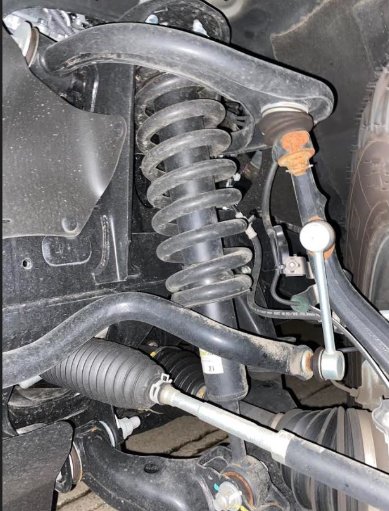

    #21013
    68
    On second thought, looks like the rust around the sway bar link on the spindle is growing.
    That's a lot of rust for a 4 month old truck in my opinion. Most of it just surface and there's no need to worry about it besides it looking like crap.
    Here are the 2 parts that look concerning to me:

    I'll try and explain it a little bit better. EDIT: Forgot to say, the rust has nothing to do with why your truck handles badly.
    So, what's circled in red is called a castle nut. There's also a pin in it. Yours looks pretty damn bad for a new truck. If you're going to be changing out the upper control arm, I would also get a new castle nut since you'll have to take it off to change UCA's anyways.
    In my opinion, the rest of the rust is fine. It's just surface rust that won't impact the integrity of the parts.
