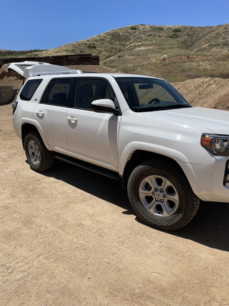

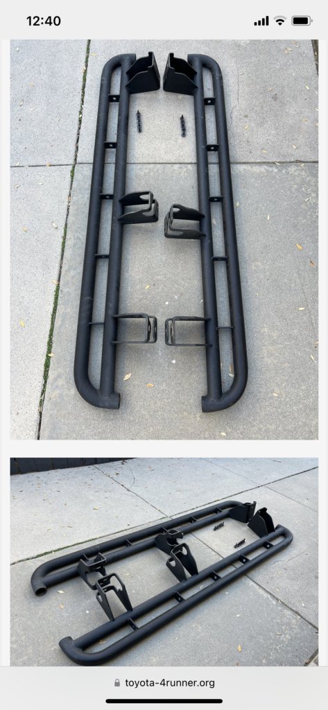

    My Rock rails are factory. Sturdy to protect body rocker panels. If bashed and ruined I can replace and/or repair. Maybe 75lbs for pair. Not a step, tucked in and up. I get in & out and my leg does not touch. Frame bolted and U- brackets are about 1/4" thick. Tube wall about 1/8".

    Looks good. Is it my imagination or do the mounts get progressively beefier towards one end?

    You view is accurate. It mounts with 5 bolts each side. The access in the U-brackets work well to allow wrench access and fit around frame features. Very strong factory bolts-I guess grade 5 or 8. The U-brackets fit onto frame rails perfectly. I suspect the entire design has a particular crash collapse intent for a wreck - Think liability for Toyota.
    Rails are supported for upward forces. If you add up the breaking strength of the bolts they are very strong.
    At some point rails can be so strong they would not collapse to absorb energy in a crash - the liability concern of Toyota. My opinion is for anticipated contact with rocks, curbs or roadway medians they will function well.
