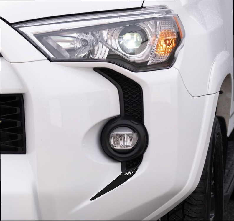

    I recently purchased a fang decal. it did not come with any adhesive or glue. What's the best way to ensure that it sticks to my truck and doesn't come off when it rains or when I run it through a car wash? Should I get a special 3M tape or should I buy a specific glue?

    If you're planning on putting this on, and leaving them on forever just put a few dabs of Gorilla Glue on the back and stick them on your 4Runner. Done.

    3M VHB is what you seek

    Mine came W/Peel off to reveal double face tape. Just get a roll of double face tape & cut to fit.

    VHB or any double sided tape could work, as long as the mastic (the actual sticky part) layer is more than 0.010” thick. Sorry to say, those ‘decals’ are not the best 3D printed models…the smooth ‘backsides’ have deep enough imperfections that any tape will be sticking to an almost sponge-like surface texture…and will fail over time.
    FYI, tapes like VHB were developed more for for use on smooth (like paint, finished metal/plastic/glass), well prepared (clean) surfaces…3M also sells a primer/tape combo that when used as directed has a bondline strength that rivals just about any epoxy adhesive out there…it crazy what they developed in this product line.
    Personally, I would lightly sand the backside of those parts, clean/wipe with isopropyl and give them a shot of clear enamel to provide a smooth finish for tape to adhere to.
    Or stick them on with a ‘flexible’ epoxy, Stay away from 5-minute, 10-15 minute types as those types are not flexible enough to withstand temperature induced problems with adhesion.
    What has worked for me in the past is a product called Flex Glue for things I’ve put together that are exposed to the sun and elements. It’s a rubberized adhesive that dispenses like caulk (it’s fairly thick/viscous) spreads like margarine and makes a mess if you’re not paying attention to what you’re doing (envision a toddler with hands in a jar of peanut butter). The only downside is it’s a slow curing adhesive, like more than a day in wintertime temperatures.
