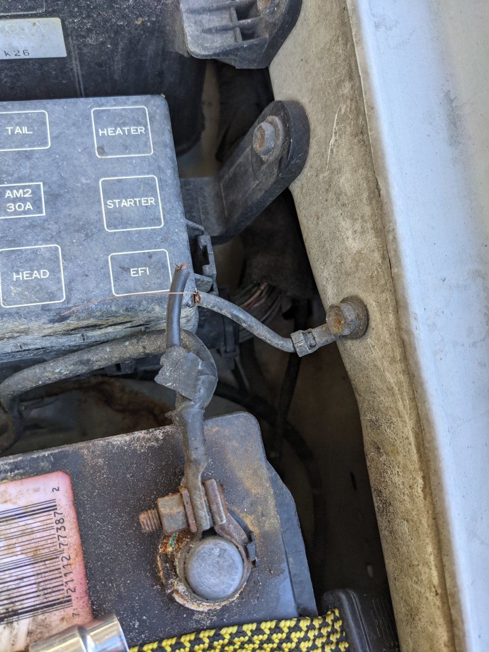

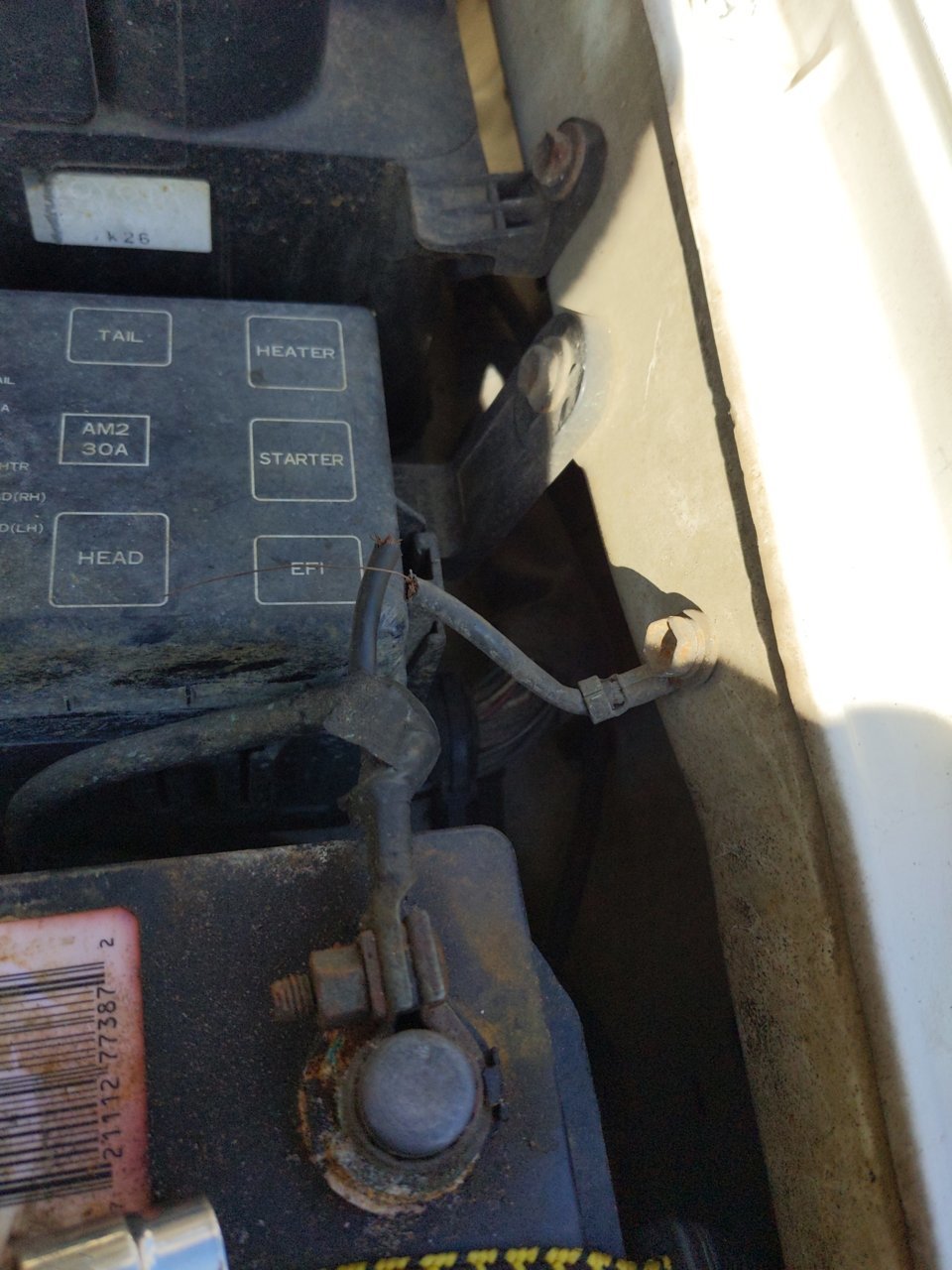

    Wanted to check my grounds. Saw this one was cut. Does anyone know what it's for?PXL_20211021_172303490.jpg

    I tightened the ground by the plenum and alternator, no changes. Hoping this sheared wire could be the problem. Didn't know if anyone had any input. Thank you all thus far.

    Bad, bad, bad!
    That's the body to battery ground. So many things are grounded to the body, it just amazing. There may be other paths to the battery, but this is THE ground for 99% of what's in the truck. INCLUDING the head ground. Head>body> battery. Because of the head gasket, the head to engine block electrical connection is virtually non-existent. Without that, little or no spark. And that's just to start. I could go on and on with systems that are affected, but you get the idea. Fix that immediately!
    Clean the bolt while you're at it. That corrosion will be a huge problem.
    Sorry, not trying to be bossy, but that's one of THE most important wires in the truck, however humble and unpreposessing it may appear. From the factory, there's only two, that one, and the one going to engine block down on the AC bracket, that the starter, and various sensors use. But almost no path for current flow for all the rest of the truck's electrical systems. I cannot imagine who would cut that, unless they're really upset with you, or the truck. And who doesn't love a 4Runner??
    Just a side note, clean those battery terminals real well. Not just the outside, "look-good" part, but the inside, where they wrap around the terminals out of the battery. A brass brush does the job like a dream.
    Hope that helps a little..
