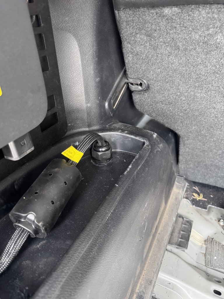

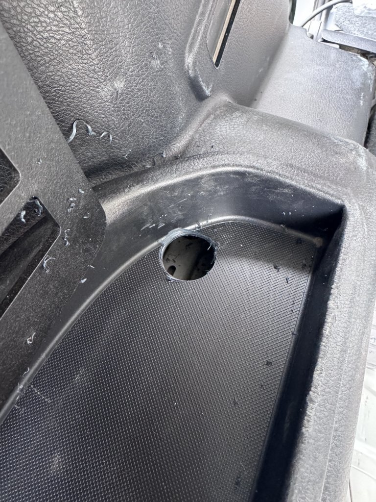

    After I got my power tray installed, I installed the RLB Switch Pro control panel, power inverter, power hubs, Anderson Powerpole connectors, Wilson Cell phone booster and ICS-Fab 4runner dash mount with USB charging kit. I also installed Ram mounts for; my phone, Garmin Inreach Mini 2 and my IPad on the ICS-Fab dash mount kit. I used 3M VHB tape and a bent piece of aluminum to mount the RLB Switch Pro panel onto to dash to the left of steering wheel.
    The power inverter was mounted in a custom built drawer system, that also contains a power hub that houses, 2 120V outlets, 1 USB-C and 2 USB-A and one Anderson Powerpole connector for the fridge. I mounted the second power hub in the center console, which provides 2 120V outlets, one USB-C and 1 USB-A connector. The power hub mounted in the center console, is mounted using bent aluminum flat stock, with 3M VHB tape, with a piece of plastic panel cut to fit, and attached to the front side of the device, to prevent items from making their way underneath.
    I mounted the Wilson Cell phone booster under the driver seat with velcro, the inside antenna is mounted to the ICS-Fab dash mount via L-brackets that are attached to another piece of plastic panel, and the outside antenna is mounted to the roof rack with a K515S luggage rack mount. I can leave the antenna down when not needed so I can get into the garage and put it up when I am traveling.
    I mounted a 50 amp Anderson Powerpole connecter, in a flush mount trailer vision cover assembly, in the rear bumper for my trailer. I may at a later date, make a power box that I can connect to this connector, to power a diesel heater and other devices, but that will be after I get a dual battery setup installed.
