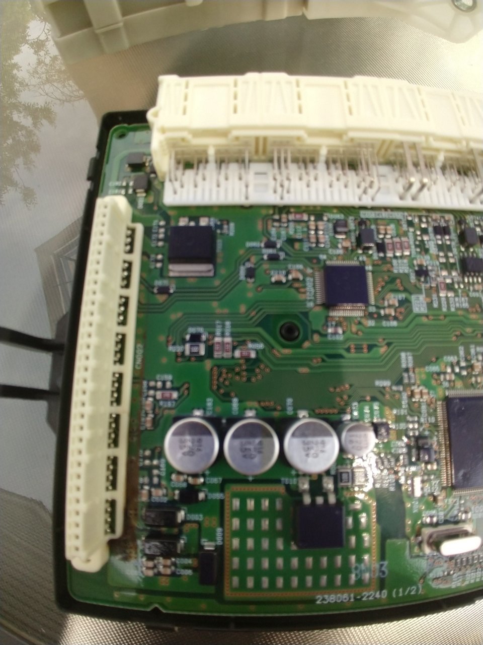

    I removed the MPX and can see obvious trauma to the board. There was an oily burned residue under the connector. I used some alcohol to remove it and can't see any visible damage to the paths. Using cotton, alcohol, and a dentistry tool I cleaned up the board and it doesn't appear to have overheated.
    Flipping the board over, it appears to have originated between e32 and somewhere else. The bottom side of the board is clean with no signs of problems. The board has some kind of coating on it and maybe moisture cause a short under the connector that then affected the coating, but not enough to blow any fuses?
    Should I put a multimeter on it and test anything specific or just pop it back in and see if it works now that it's cleaned up?

    After cleaning...

    Hmm... that's interesting. Oily burned residue but no physical damage to the board or paths. Was the corresponding connector on the fuse box discolored? Does the fuse box itself smell burned at that 32 pin header connector? Post up some pictures of the fuse box please if you can.
    Pin #32 on the MPX board connector is ignition power from the IG1 NO. 1 Relay (internal to the cabin fuse box) and is fused by the 10A ECU-IG NO.2 fuse. Double check that fuse just in case.
    The coating you are finding on the MPX circuit board is called a "Conformal Coating" that actually protects the circuit board and its components from environmental conditions, such as moisture in the air, etc. They are usually a plastic polymer of some kind. Nothing to worry about, and I wouldn't try to remove it if at all possible. If a liquid caused a short it would blow the corresponding fuse before damage occurred.

    My cell phone camera isn't great, but all of the residue cleaned up. The inside of the connectors didn't have any visible damage, but I didn't look on the back side of the fuse box. It didn't have that burned electronics smell, but I can't see well enough under the connector to really know what that side of the board looks like. I would have to desolder all 32 pins and I guess what you would call the rivets. I ordered a used MPX already today just because the darkening makes me think we're at the scene of the crime...but if I can fix it without using the part, that's great.

    Good, that eliminates the fuses. I'm no electrical guru as there is a lot I don't know/fully understand, but If the relays don't look like they have any visible signs of damage I think they are probably fine. I don't remember specifically which relay is which on the fuse box PCB. I attached two pictures showing the soldered pins for all the relays on the back of the board. Orange is the smaller relays (door lock control relays), purple the larger relays (Ignition, ACC, Fog, Backup), light blue is the resistors across the relay coils. Visually inspect, but again I would be surprised if there was damage.
    Also, looking at the long 32 pin PCB header, I don't see any signs of heat damage caused by a short/greater current load. If something shorted there would be evidence. Pin #32 is Igntion power on the PBC header. Pin #11 is the pin the MPX grounds to effectively close the relay contacts and "turn on" the ignition relays NO. 1, 2, 3, 5, and the ACC relay so power goes to the fuses for each system in the vehicle (there is no IG NO. 4 relay).
    I am leaning towards this being a bad main body MPX. The MPX grounds the relay control circuits when the key is in the "ON" position. I think a replacement will probably solve the issue.
