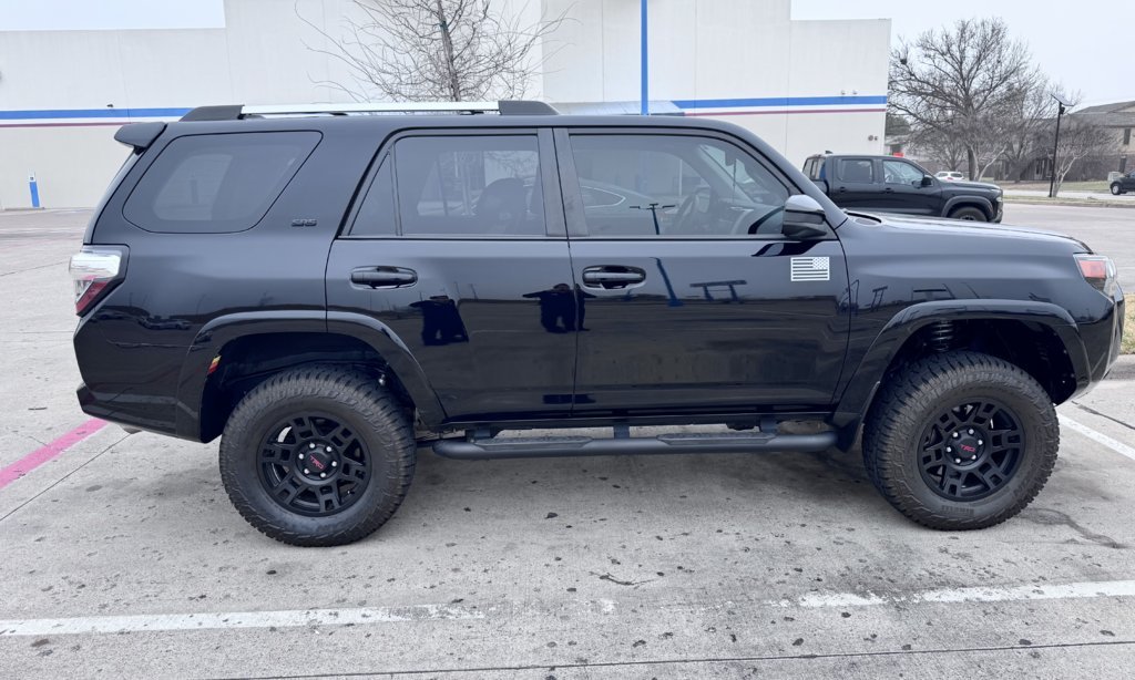

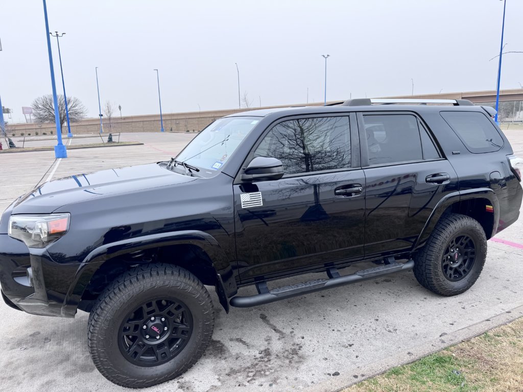

    Just installed the Eibach Stage 2 front coil-overs with rear shocks and springs. So far the ride quality is amazing. I didn’t adjust the coil-over perch from how it came, but thought about lowering slightly. What do y’all think?

    I'd give it time to settle first, then take measurements to see if it's level or if you still have some rake. If you never tow or put heavy things in the back, you could get away with level if you like the look. Otherwise, you should adjust to maintain some degree of rake
    Edit: looks good by the way!

    can you take a few more far away and level? its lookin super great and high

    Yeah I’ll snap some more. My driveway and street isn’t level so I have to go find level parking spots lol

    My understanding is that Eibach springs don't settle (ergo their million mile warranty on them) but since you got the adjustable coil-overs, might as well adjust them down a bit.

    I have them on mine. From factory settings they ride too high in the front. You will have to lower the front down a lot. Measure all four corners from center of hub to bottom of fender and get your numbers then lower the fronts to match the rears.
