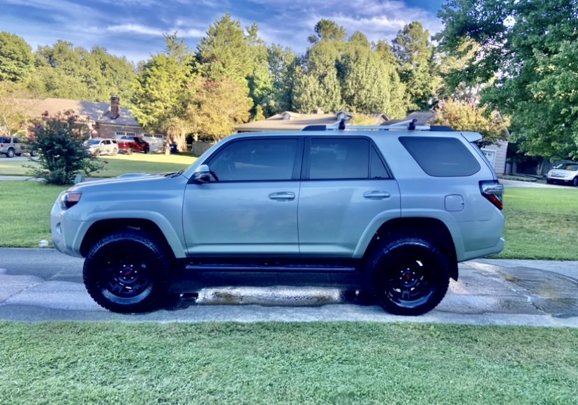

    After 3+ years of ownership, I finally have my T4R sitting the way I want. I picked up the Eibach pro truck lift and Ironman UCA's while they were still selling around $600 years ago and installed them last year. The difference in appearance and handling is incredible, it sits pretty level with a slight rake, no more nosedive when braking or body roll around turns, a very pleasant and tight ride IMO. Also, the steering wheel shake around 55-60 mph that Toyota had been unable to fix went away after the lift and UCA's, this was on the stock tires.
    I considered the JBA UCA's as they looked great for the price, but the owner at JBA confirmed they would rub with 285's unless I used spacers or changed to wheels with a different offset. I like the stock wheels so I went with the Ironman UCA's instead. They look very sturdy and appear to be well made.
    I finally wore out my stock tires and just had the Firestone X/T tires (285/70/17) installed at Costco. There is no rubbing at all, even when turning at full lock going forward or in reverse and compressing the suspension. I'll have to see how it does off road and fully flexed but it looks like I will be in the clear. I did not notice any difference in handling, acceleration and braking feel unchanged.
    I went back and forth on which tires to buy and it was between the KO2 or Wildpeak AT3 until I came across a great deal on the Firestone X/T's. There is not much information on these tires out there, at least on 4runners, but the reviews I could find were all positive, especially in wet weather and snow which was high on the list for me. They are only 50lbs each and have a 50k mile tread warranty. Costco had them for $258.99 and offered free mounting/balancing which I felt was a good deal.
    Just wanted to show what this setup looks like in case anyone else out there was considering a similar setup. Next I will be saving up for rock sliders and skid plates. I absolutely love this truck and plan to keep it in our household for as long as I live.

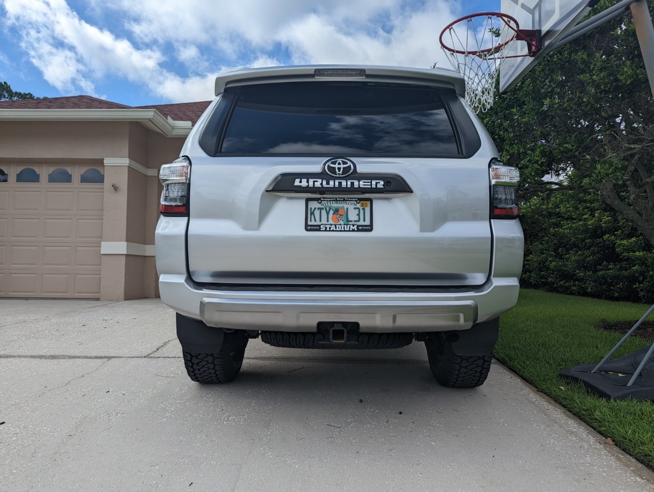

    Would you mind getting more photos when you have time. Front (curious on ground clearance appearance) and back at least. I have a very similar set up but went with Ironman all the way around. I love it! I just can’t get over the feeling for some reason my ground clearance didn’t go up much (haven’t measured yet) but by looking at others in person mine doesn’t seem to be where it should be. Also I’m currently running 265s and am trying to find what 285 I want when they wear out so your write up helped thanks!

    Sure, here are a few more I took along with one on stock tires after the lift (but I have a trailer attached which is bringing the back down a little). I tried to get some pics from the side with a ruler but they were not coming out right due to the angle. Hopefully these help you a bit. Which Ironman lift did you go with? The Eibach was very accurate as far as advertised lift. I do have a slight lean towards the drivers side but I'll address that someday.

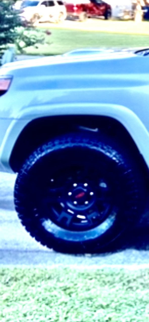

    B0ED11CA-7014-424A-9414-8893421DA557.jpg 78EE3D8B-2D3E-4A00-B709-D2BCC9254DD3.jpg
    Above is 265s, tried to play with lighting on wheel well to better show the amount between tire and car.

    285s
    96FE9161-C5F4-4B22-BB56-F3B02965E1AA.jpg B41AEF6F-ADD6-4A16-821F-29BD71C9F1EB.jpg

    If they made more 275 tires they would be perfect. The 265 tires look small and the 285s rub if you don’t have the Offroad wheel. Did you get max caster from your alignment?

    QUOTE="HarrisNC, post: 382776, member: 21571"]If they made more 275 tires they would be perfect. The 265 tires look small and the 285s rub if you don’t have the Offroad wheel. Did you get max caster from your alignment?[/QUOTE]
  28. Sep 9, 2022 at 4:05 AM
    HarrisNC
    HarrisNC New Member
    May 19, 2021
    #21571
    200
    2022 Limited
    I don’t remember seeing what your caster was, on my 17 Offroad I had 3.5 caster and 1.75 front lift. I had more than enough room for, but I had the Offroad wheels and NO mud flaps. If you want to keep the mud flaps you’d have to get closer more caster and trim the bumper.
    nimby likes this.
  29. Sep 9, 2022 at 5:20 AM
    4,814
    This is correct. If you're rubbing on the mudflap, your caster needs to be pushed forward. Shouldn't be a problem since you have UCA's.
