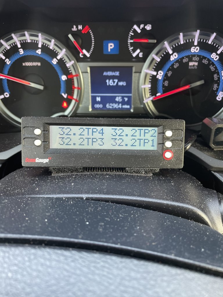

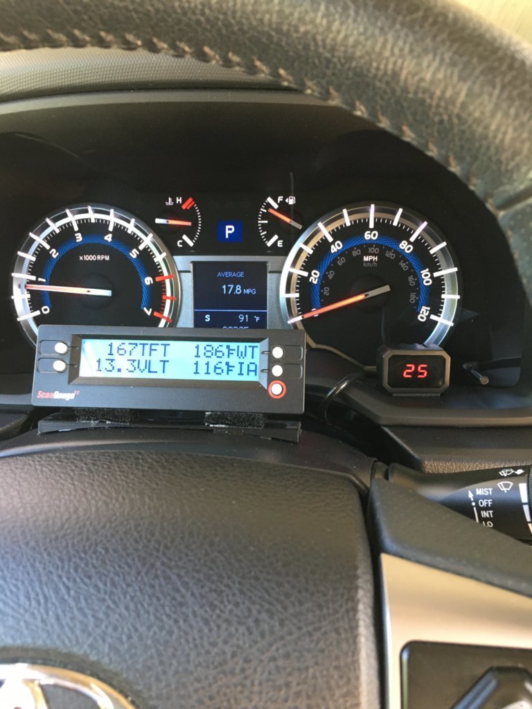

    I have a Scanguage2 mounted on steering column. It provides lots of real time outputs including tranny temp. Can also check and clear CE codes.
    For high speed driving 85+ I really pay attention to my 4 tire pressures. When using engine/tranny hard I monitor coolant and ATF.

    thats bad ass. Does it just plug into the OBD2?

    Yep, I plugged it in and wrapped the excess around my wiper stalk. Works well enough at keeping it tidy.
    It's set to power off when engine's shut off too.

    apologies, does it monitor the trans fluid. I know you said for tire pressure

    Yes, it will do trans fluid (pan) and torque converter temps

    How long are you guys driving for when you’re showing these temps?
    I live in south Florida, and use Scangauge 3, unloaded and a good drive, meaning 1 hour + my pan is around 180 and torque converter temps get 195 and climb down quick once I get moving and lockup happens.
    isn’t normal operating temp for the trans around 190-195? I have seen converter temp get 200 in stop and go Florida traffic, but if I’m on freeway or a 55 mph road, it stays same as pan.

    Those numbers are pretty good and low TBH. I have gotten to 221 and higher when towing and loaded in the back. The scanguage has also saved me several times when the ECU throws in a code, I can actually clear it right away so worth to me doing that.
