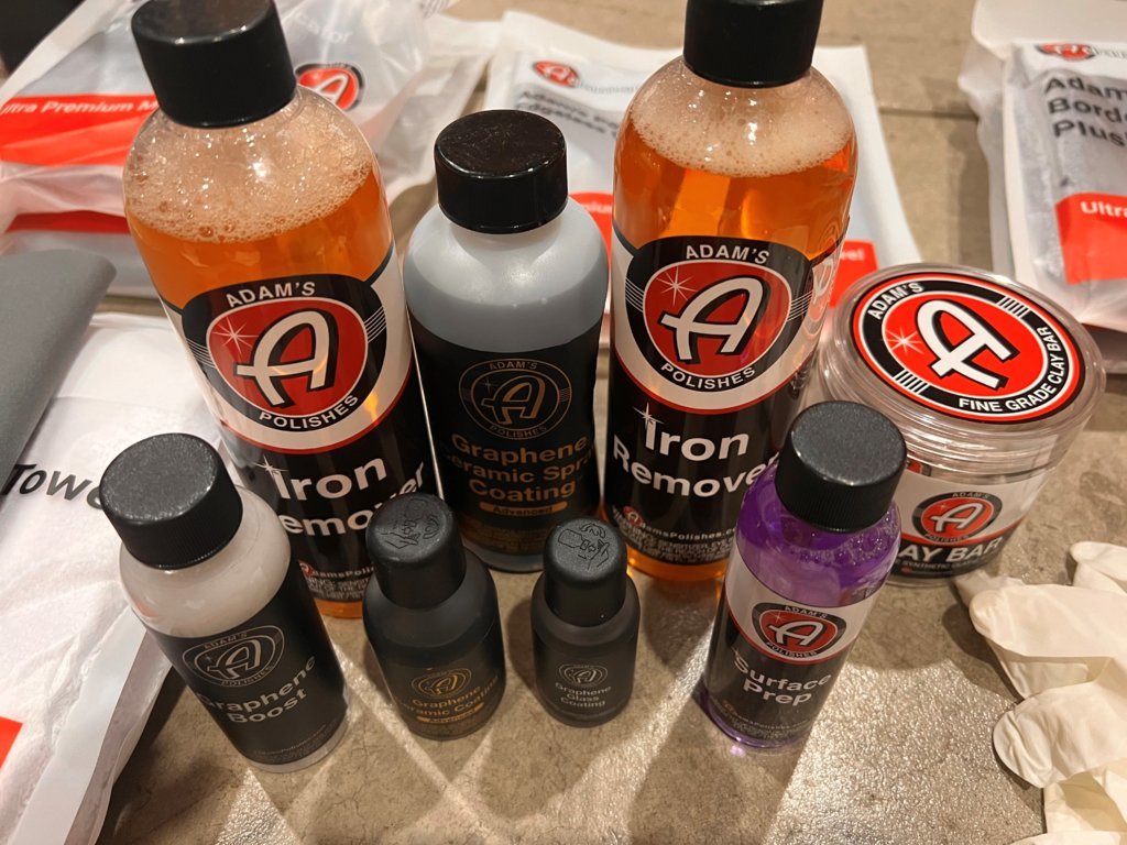

    I decided to go with Adams's Graphene ceramic kit after recommendations from YT and friends that have used it, bought this whole kit for about $200 on a Black Friday sale.

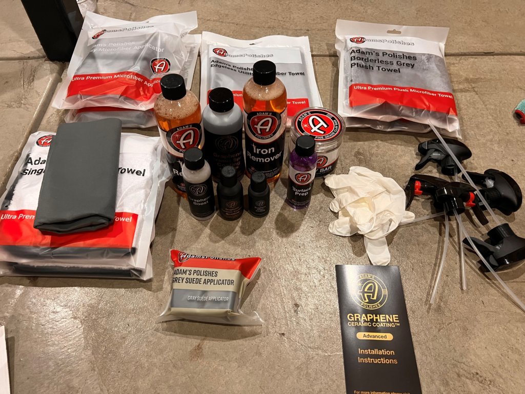

    This is everything that came with the kit:

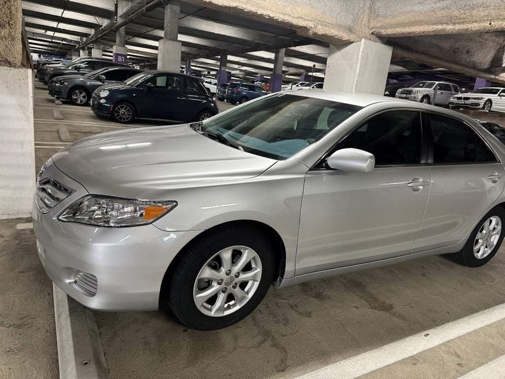

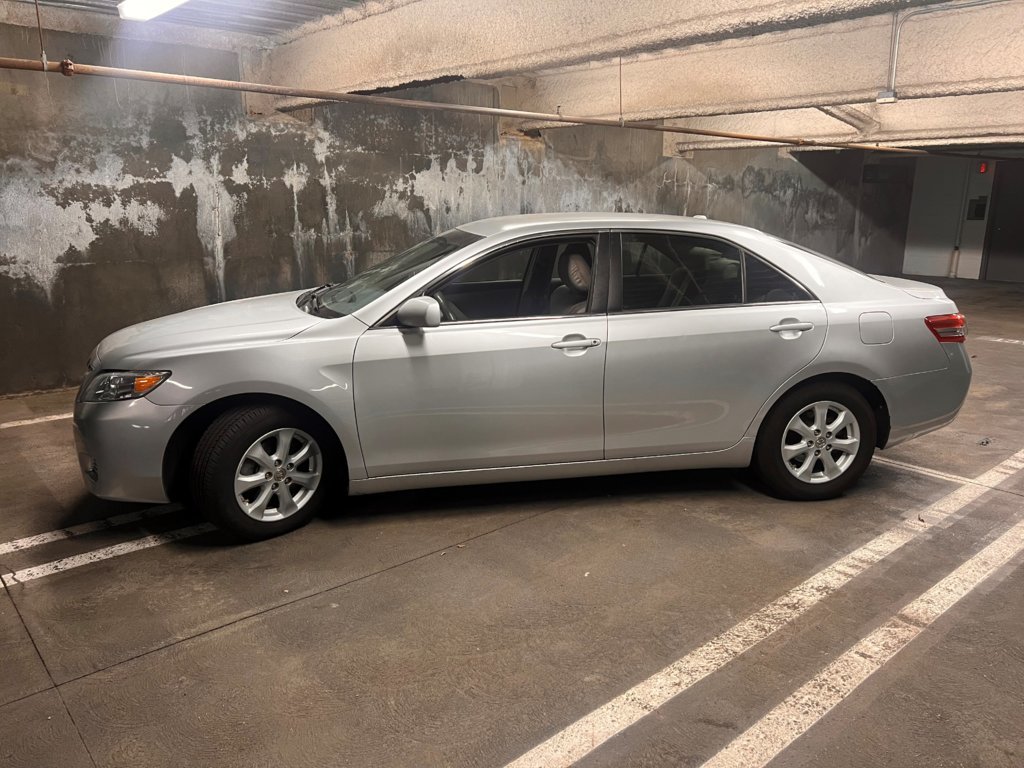

    Camry:
    Silver color is a little easier to spot when the curation has happened but still hard to see, it all depends on temperature and moisture at the time. UV flashlight was useless to me since the parking lot lights could not be turned off.
    After applying Graphene coating (small black bottle) in a small area, I used a timer of 3 minutes and I would wipe off since at that point the towel felt "grabby" when wiping ceramic off the applied surface, (again, make sure to do research on how to apply this) I found that the best method was to wipe off with Microfiber towel and then with the grey suede towel as you can feel more of the car when wiping off.
    On all the windows I used the glass ceramic (tiny black bottle) and same method, wipe after 3 minutes.

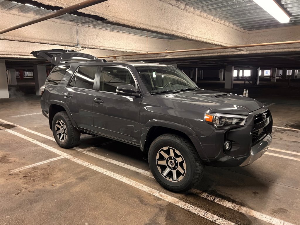

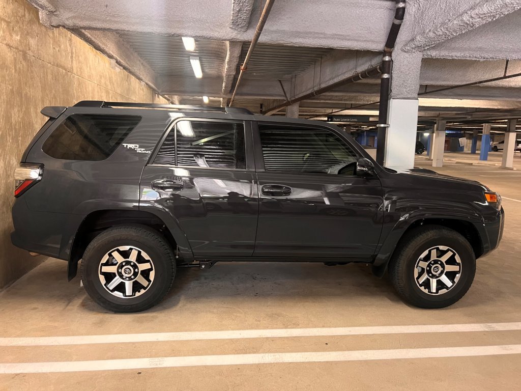

    4Runner:
    Underground color was even harder to see curation point "rainbowing effect" , I used the same method as the Camry.

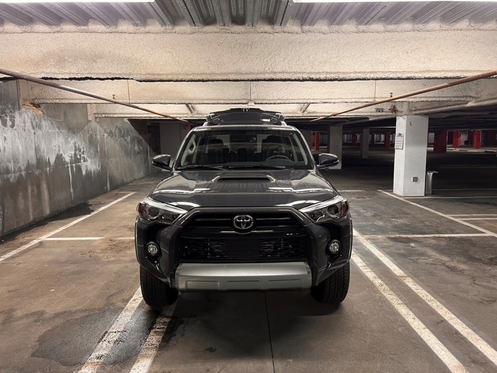

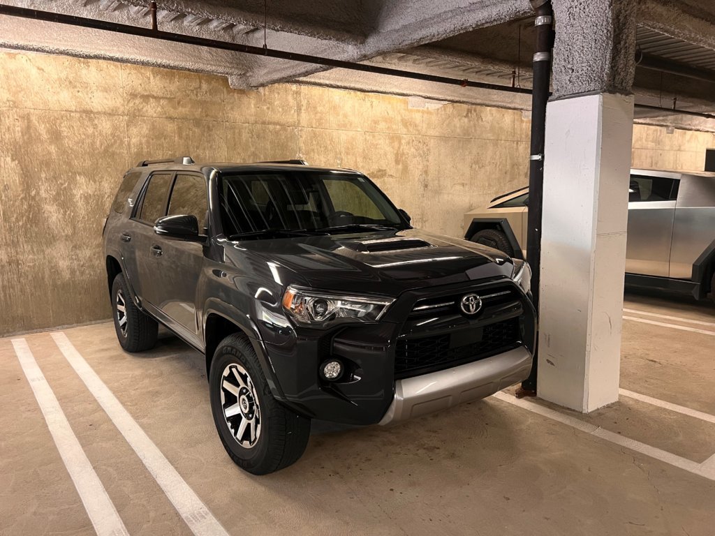

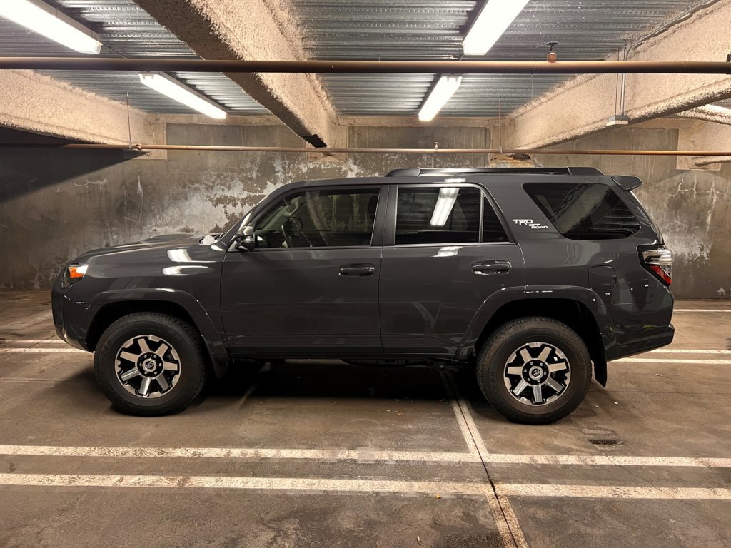

    4 Month Review:
    Since I use my cars often, they do not stay clean for long, so the coating is not noticeable most of the time, but if you run your fingers through the paint its feels smooth and water just runs off with ease. I wash them 2 times a month and it’s a JOY to do so, spraying them down with just water takes care of 80% of the job and when drying with towels paint just feels so smooth. The paint really shines much better than before especially when car has been just washed.
    Water "floats" on paint.

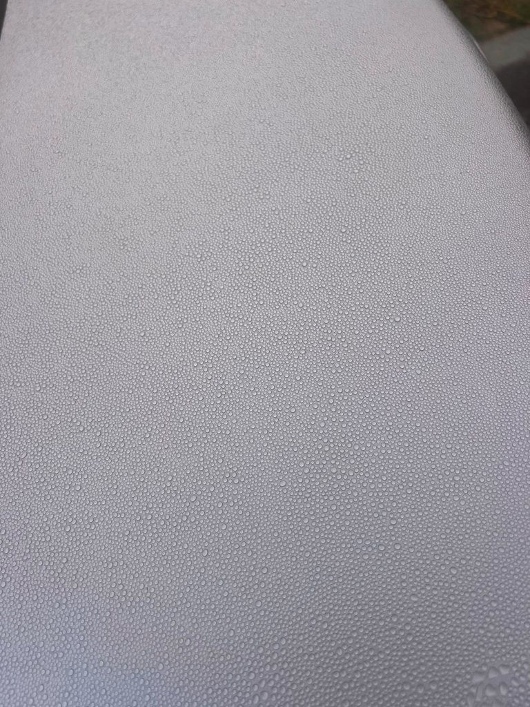

    After 3 months, I used the Ceramic booster (white solution) again 1 bottle was enough for both cars. As its name suggest; it supposed to boost the hydrophobic properties that is already in your car when you applied the ceramic coat. Application should be after a wash, sprayed and wiped off with 2 different towels. I did notice a shinier coat after application but not much different than when I originally applied ceramic coat, same as before paint feels smooth to the touch, water repels very quick and washing them is a breeze. Here are pictures AFTER applying the booster (3 months after ceramic coating application):
    Final thoughts:
    Adam's products have good reviews and are quality products. Their advertising of 9 years is definitely a stretch, and my expectations are 3 years max. Pricing seems to be the same when compared to other products and should be bought as a kit. $200-$220 for 2 uses/vehicles seems to be a fair price, when considering 1 car would cost around $2000 - $3000 when having them professionally done.
    Planning on applying the ceramic booster after a couple of months along with washing truck consistently, making sure to completely dry it as water marks on this Underground color seem to be very visible.
