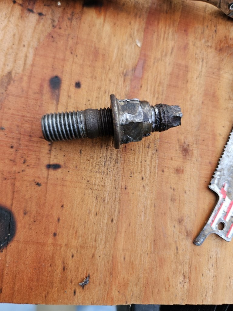

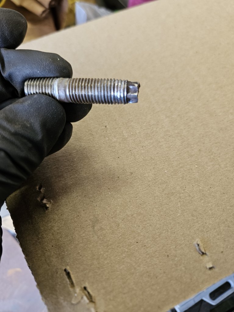

    - My truck has been a California truck its whole life so I had zero issues with seized hardware. YMMV WILDLY especially if you are in the rust belt. I still opted to buy aftermarket locking nuts to replace all of the OEM ones as they are one time use. Kept the studs as they were.

    - Installing the rear most manifold nut on the driver side will test all of the patience you have. Since I had 3/8" less room to install the nut on that stud (EGR flange too close), I opted to remove the stud and replace it with a bolt (not ideal) but it's sealed up. There was no possible way to get a nut tightened in that small of an area and even tightening a bolt in that area was difficult and was only reachable to tighten from underneath the truck with a flex head ratcheting wrench (3 clicks at a time)

    External Torx socket set for swapping EGR studs to the DT headers or removing OEM manifold studs
