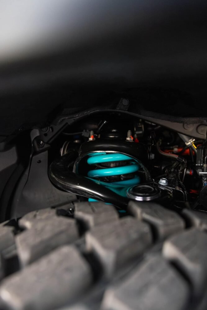

    Here we go guys, here are all of the parts that Dobinsons offer for the new 2025+ Toyota 4Runner. Pay attention to the Hybrid and non-Hybrid options, as the coils lift different amounts between 2, since the Hybrid weighs more than the non.
    Complete Lift Kit Builder Pages
    These pages show all possible options on one page for you to build a complete kit, with either the IMS or the MRA shocks.

    Front Struts - These are all extended travel and require a diff drop kit and UCA's for proper clearance and travel
    GS59-660 - Twin Tube Extended Travel, fixed coil seat height for 0-3" of lift
    IMS59-60660 - 2.6" Body, Extended Travel, adjustable height monotube for 0-3" of lift
    MRA59-A660 - 2.6" Body, Extended Travel, 3-way adjustable valving (high and low speed compression and rebound adjustments), height adjustable monotube for 0-3" of lift

    Front Coils for 4Runner Non-Hybrid - Offered in Teal, Black and Red Colors
    C59-882 - 2.25" lift with stock weight
    C59-816 - 2.75" lift with stock weight, or 2.0" lift with 110-220LBS added front end weight (bumper, winch, skids, etc)
    C59-818 - 3.0" lift with stock weight, or 2.5" lift with 110-220LBS constant added weight
    Front Coils for 4Runner Hybrid - Offered in Teal, Black and Red Colors
    C59-882 - 2.0" lift with stock weight
    C59-816 - 2.5" lift with stock weight, or 2.0" lift with 110-220LBS added front end weight (bumper, winch, skids, etc)
    Add preload with IMS or MRA struts to tune the lift height up as needed, like 1/2" lift via preload for 3" of total lift

    Front UCA's
    UCA59-212K - Billet Aluminum, reuses OEM ball joints for a maintenance free life, OE-style high quality rubber bushings for maximum NVH dampening and longevity, No greasing or maintenance required at all, completely noise-free operation, Adjustable on-vehicle for quick and easy alignment, Adjustable Camber and Caster for perfecting the vehicle’s handling

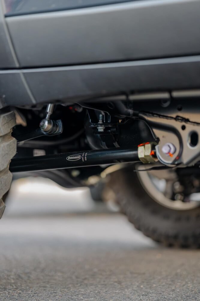

    Adjustable Rear Trailing Arms
    These allow the rear pinion angle of the truck to be set properly once it has been lifted. They're also much beefier than stock
    WA59-547K - Dobinsons Adjustable Rear Lower Control Arms with OEM style rubber bushings installed
    WA59-747K - Dobinsons billet Adjustable rear lower control arms with OEM style rubber bushings installed
    WA59-571K - Dobinsons Adjustable Rear Upper Trailing Arms with OEM style rubber bushings installed
    Rear Panhard Rod (track bar)
    This is recommend with a 2" lift or more. It allows you to re-center the rear axle under the frame
    PR59-1421 - Adjustable length, new OE style rubber bushings already installed

    Rear Sway Bar Links
    SE59-591 - Adjustable length rear sway bar links for 1-4" of lift
