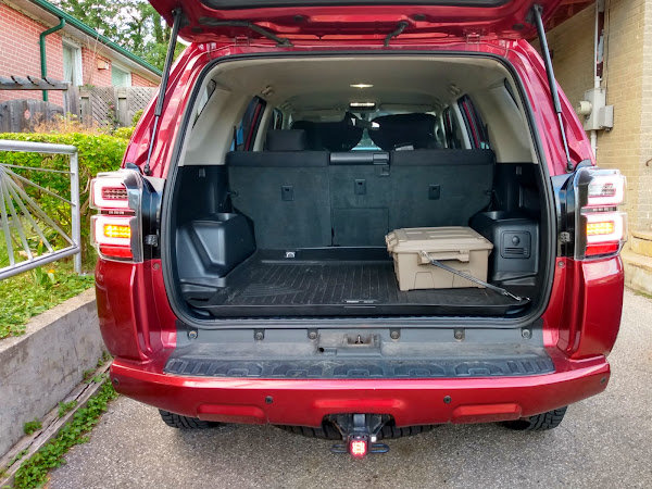

    Installed mine in January 2023. Backed it into snowbanks a couple of times. Still running strong 16 months later:
